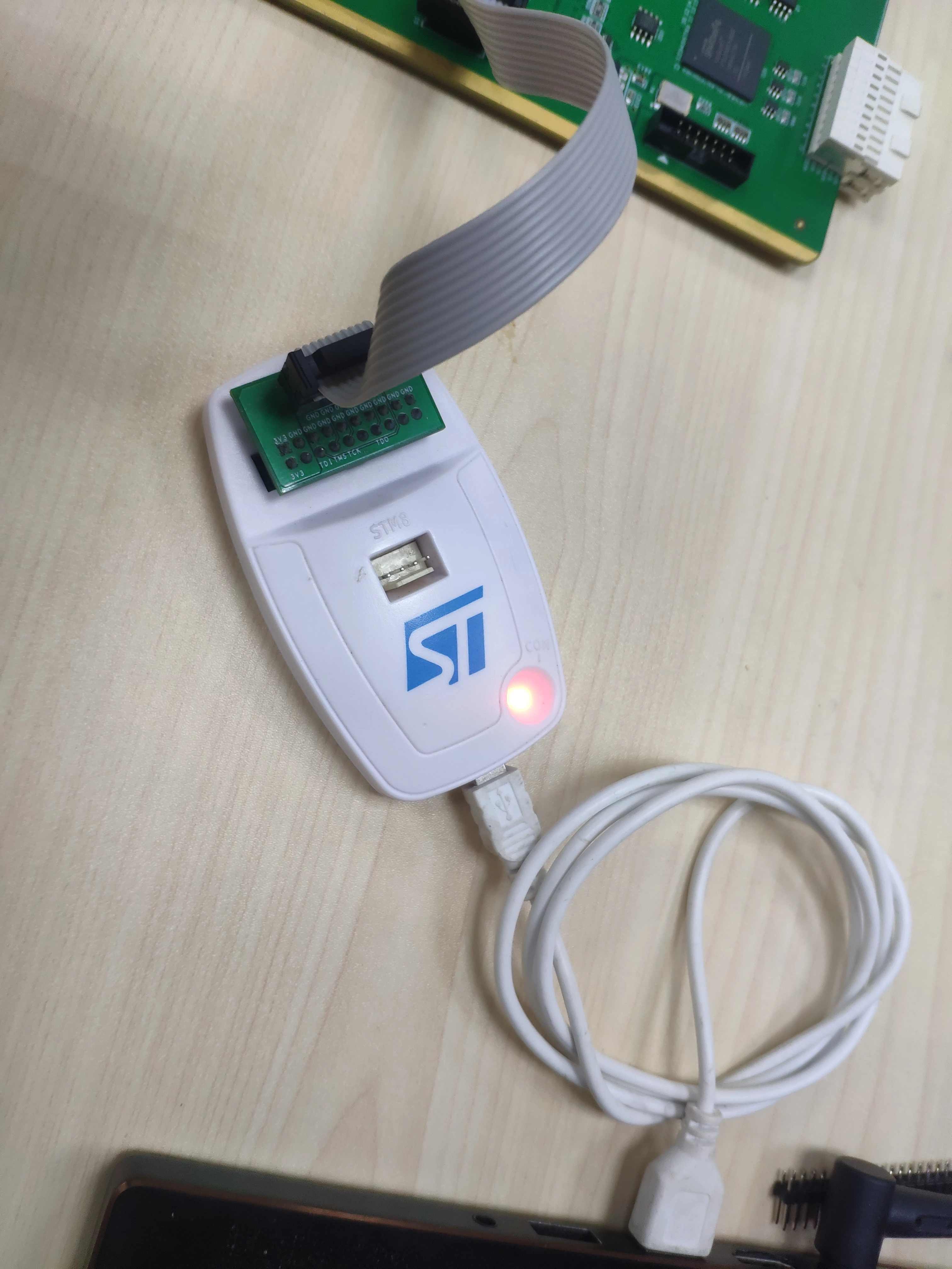

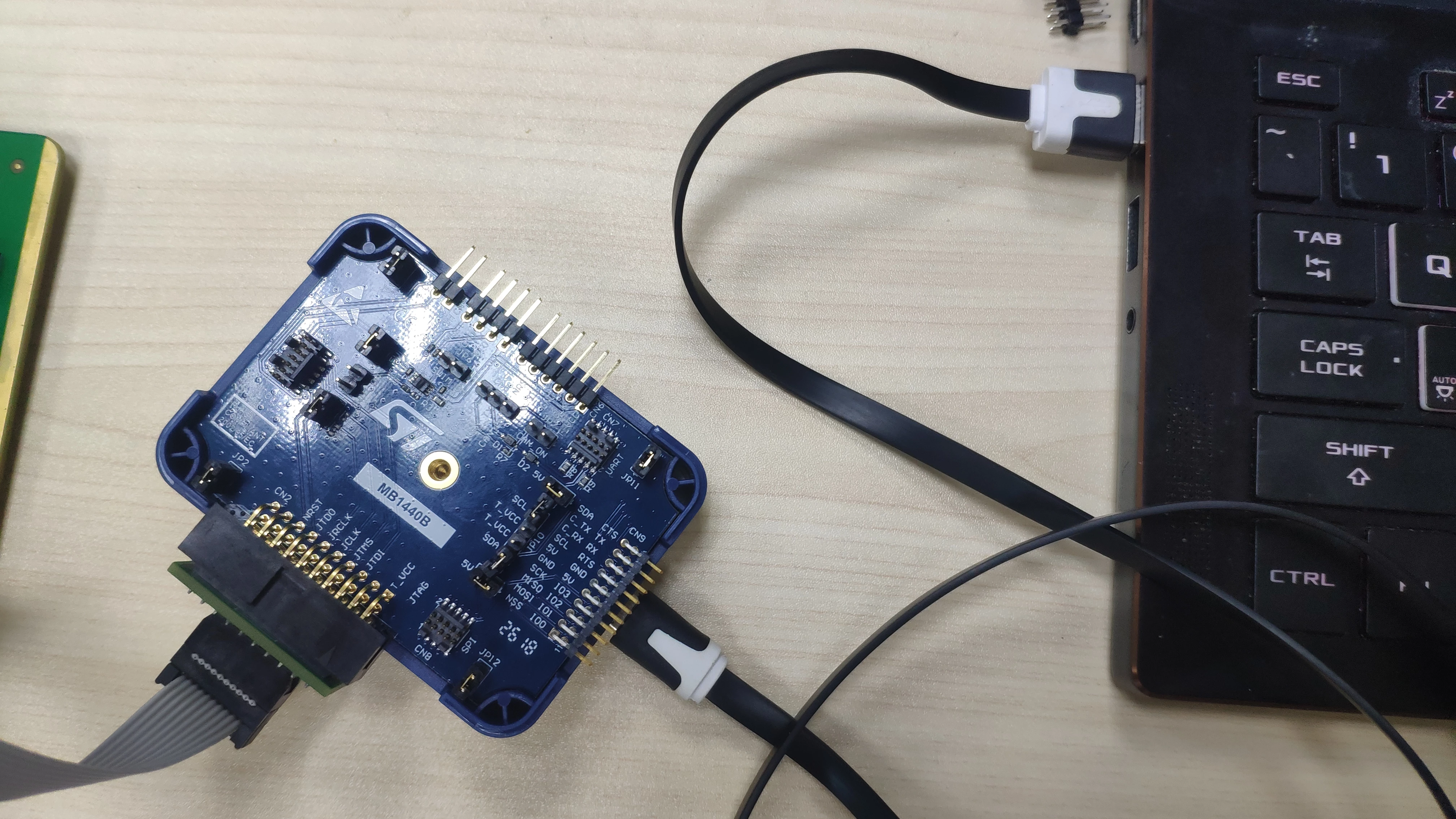

The PC can recognize STLINK-V3SET,but cant connect target!
I can use the STM32CubeProgrammer to recognize the ST-LINK V3, but I can't connect to the STM32. I can connect back to ST-Link V2. Use the SWD mode. The ST-LINK V3 firmware is V3J5M2B3S1.Help�?
I used the logic analyzer to grab the SWDIO and SWCLK signals and found that the ST-Link V2 has a signal, but the ST-Link V3 has no signal.

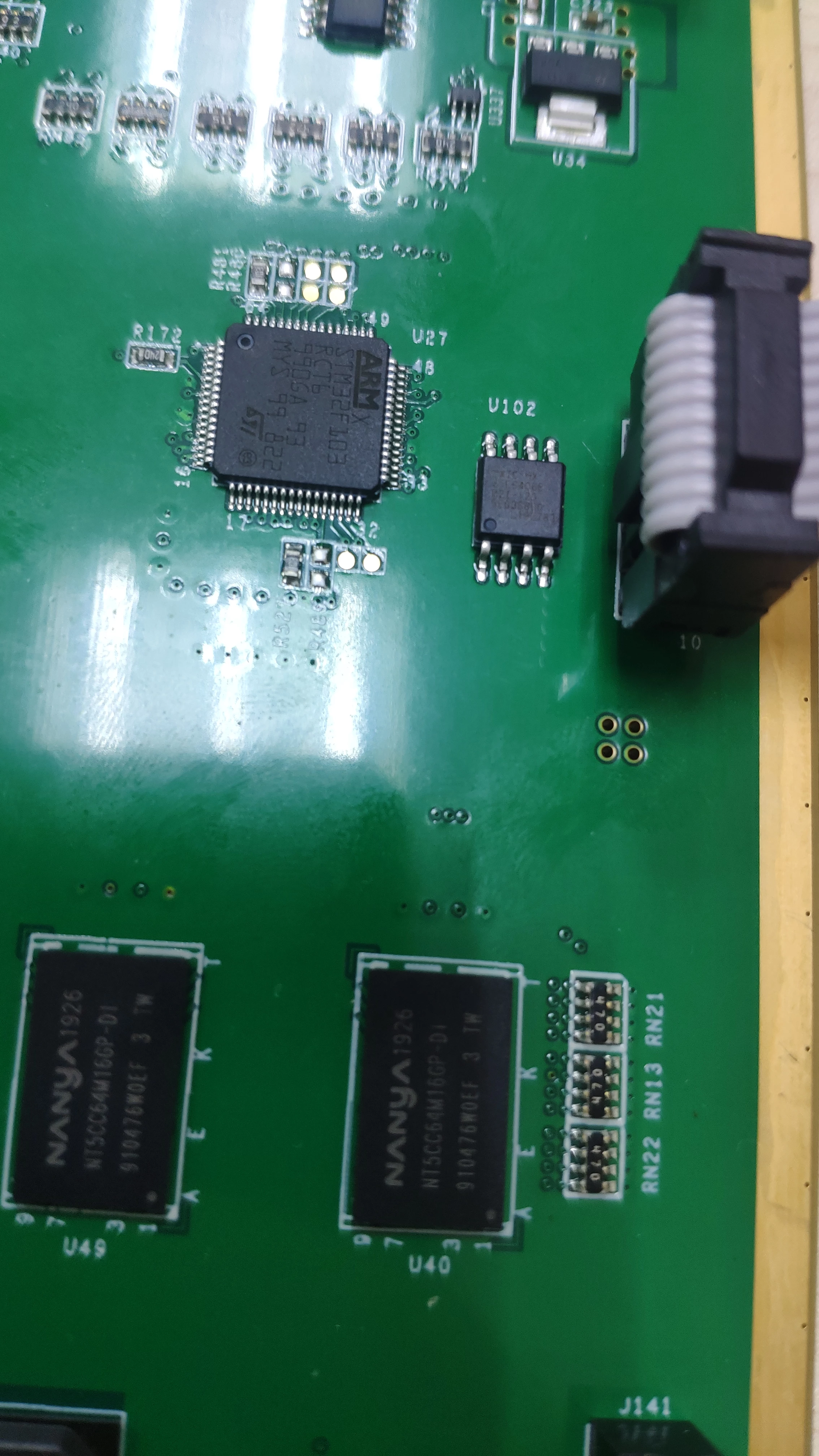

What exactly is the target?
bjhon
bjhonAuthor
September 24, 2019
0690X00000ARZH8QAP.jpgMy own board, STM32F103RCT6, and I also tried other boards, stm32f429

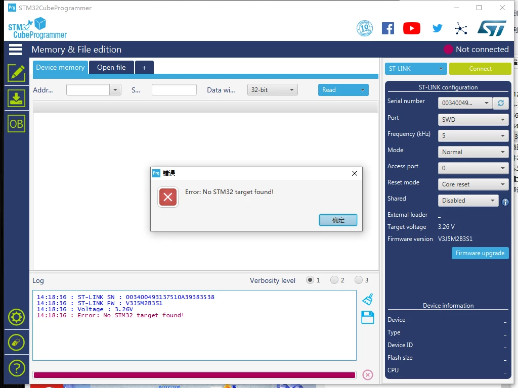

September 24, 2019
Try dropping the connection clock frequency. ​
bjhon
bjhonAuthor
September 24, 2019
0690X00000ARZJJQA5.pngI have already reduced the frequency to the lowest:tired_face:
