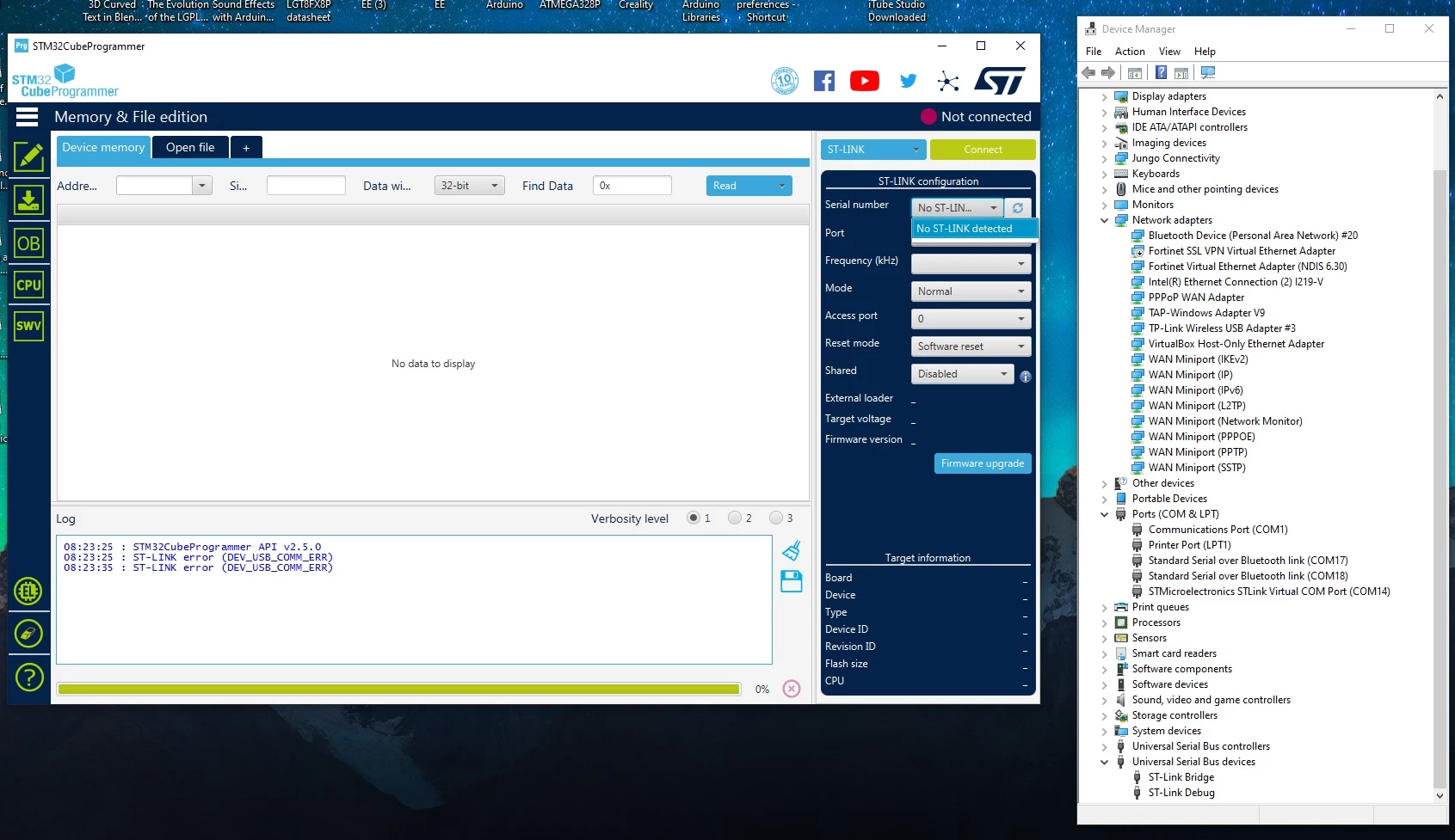

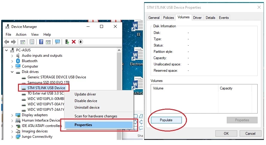

The new unit of STLINK V3SET received on 17/2/2021, - Cannot performs "Firmware upgrade" under STM32CubeProgrammer - Cannot "populate" its flash disk, 0MB, hangs for long time - Cannot connect even via UART option under STM32CubeProgrammer

Why does it need to populate? It is designed to provide a simple drag-n-drop for a binary file.
Why would it connect as a UART?

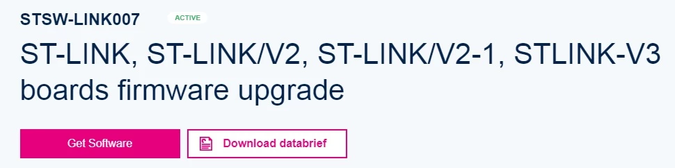

Download the Firmware Update application separately
https://www.st.com/en/development-tools/stsw-link007.html

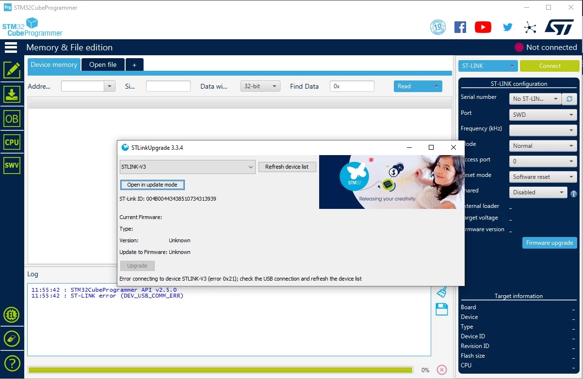

Click to get it into upgrade mode, it should enter its DFU mode and reenumerate.
  • There is no physical USB disk drive of 1MB that allows me to drag-n-drop files as per your mentioned.
  • Since STLINK is not detected but it has its COM port detected, so I try connect it via COM14 as shown on the picture, merely for trial-n-error.
  • en.stsw-link007_V2-37-26 - To upgrade firmware for ST-LINK V2, V2-1 only, you sure can be used for ST-LINK V3SET ?

  • Tested using STLINK UTILITY, unable detect as well and standalone STLINK Upgrade.

Ricky Gai
Ricky GaiAuthor
Feb 22, 2021 2:56 AM UTC
Thanks for the hint, actually I referred to the databrief PDF document which I downloaded on 16/2/2021, even now if you clicked on the "Download databrief" button, the document title is stated like picture shown below, that's why is confusing me:

Hi @Ricky Gai​ ,
Sorry for the delay.
Can you please try to use STLink utility instead of STM32CubePRogrammer to confirm if issue is related to CubePRogrammer or STLINK V3SET?
Try also to decrease the frequency to 3300 KHZ and tell me if you are able to connect?

Thanks for the feedback, apologizing I have returned the STLINK V3SET to Element14 already.
Yes, I used STLINK Utility and successfully updated to latest firmware for STLINK V3SET.
