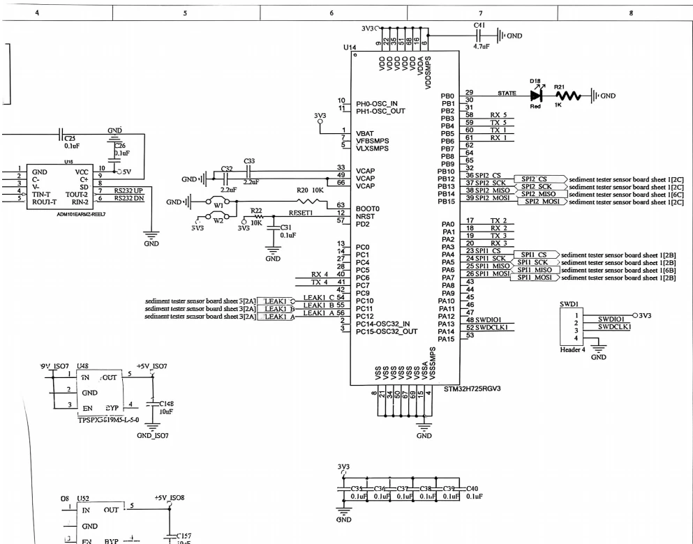

The microcontroller STM32H725 cannot be programmed
The schematic is shown below. I have pulled  down BOOT0 to ground through a jumper , power supply voltage is normal. Could you please help me check if there is a problem with the MCU configuration。

Hello ​@WUDIYE and welcome to the ST community,

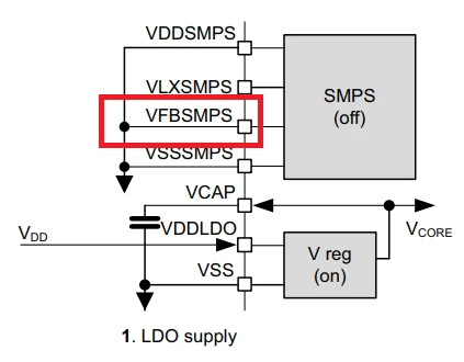

VFBSMPS should be connected to the ground in LDO configuration:
From RM0468 / Figure 19. System supply configurations:
