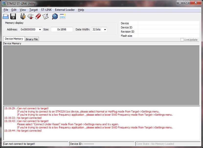

I am using stm32g030f6p9 microcontroller. I tried to make flash read protection:
 	if ((FLASH->OPTR & FLASH_OPTR_RDP) != 0xbb)
 	 FLASH->KEYR = 0x45670123;
 	 FLASH->KEYR = 0xCDEF89AB;
 	 while (FLASH->SR & FLASH_SR_BSY1);
 	 FLASH->OPTKEYR = 0x08192A3B;
 	 FLASH->OPTKEYR = 0x4C5D6E7F;
 	 FLASH->OPTR |= (0xbb << FLASH_OPTR_RDP_Pos); //read protection of memories active
 	 FLASH->CR |= FLASH_CR_OPTSTRT;
 	 FLASH->CR |= FLASH_CR_OPTLOCK;
 	 FLASH->CR |= FLASH_CR_LOCK;
After a power reset, I see that my program is not running and I no longer have access to the microcontroller (tried through STM32CubeIDE, STM32 ST-LINK Utility, STM32CubeProgrammer).
I have tried every possible Mode and Reset Mode.
0693W00000YAnIFQA1.png0693W00000YAnFgQAL.pngWhy is this happening? How can I regain access to my microcontroller?

I can't even go into option bytes to change something there. And as you can see from the piece of code, I set 0xbb there.

Multiple threads here
The G0 is definitely not going to be supported by ST-LINK Utilities, it hasn't been updated in years now.
You'd want to be using STM32 Cube Programmer
