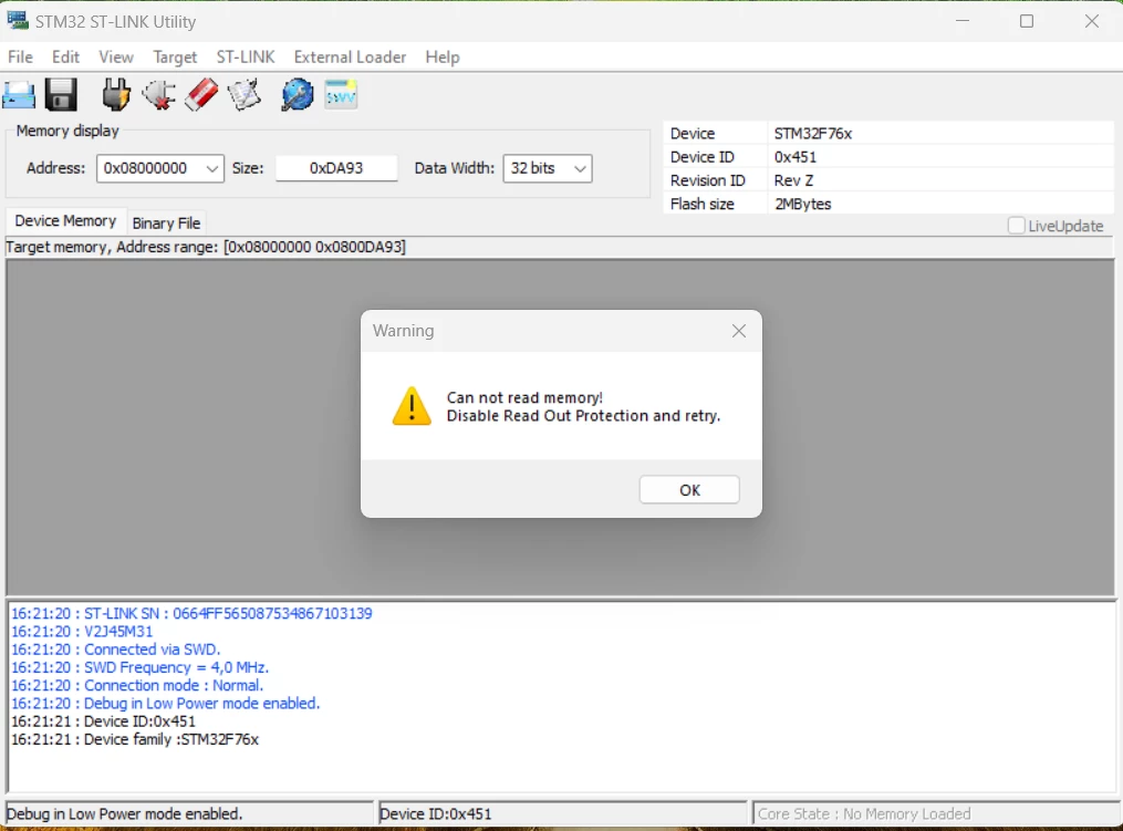

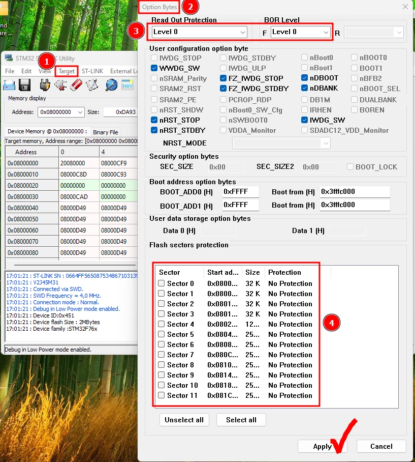

DK.7
September 23, 2024
After my experiments with Flash, I got an identical problem. How I fixed it is, see screen1.png2.png

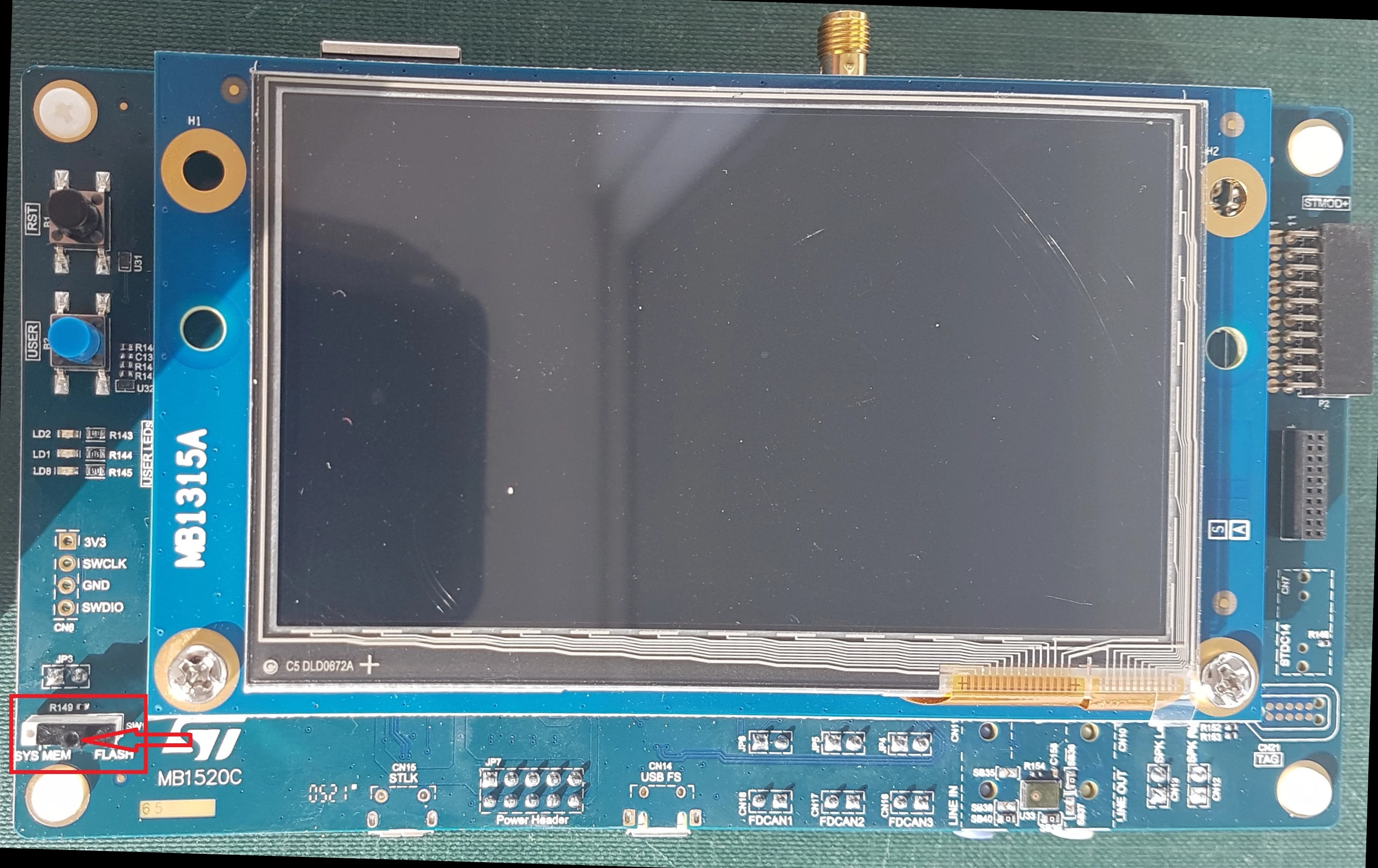

February 8, 2025
I had this same problem on the STM32H735G-DK and reason of this was a wrong firmware uploaded which blocked SWDIO. All the time ST-LINK-V3E put file named "FAIL.TXT" in the mass storage device entries.
Solution:
