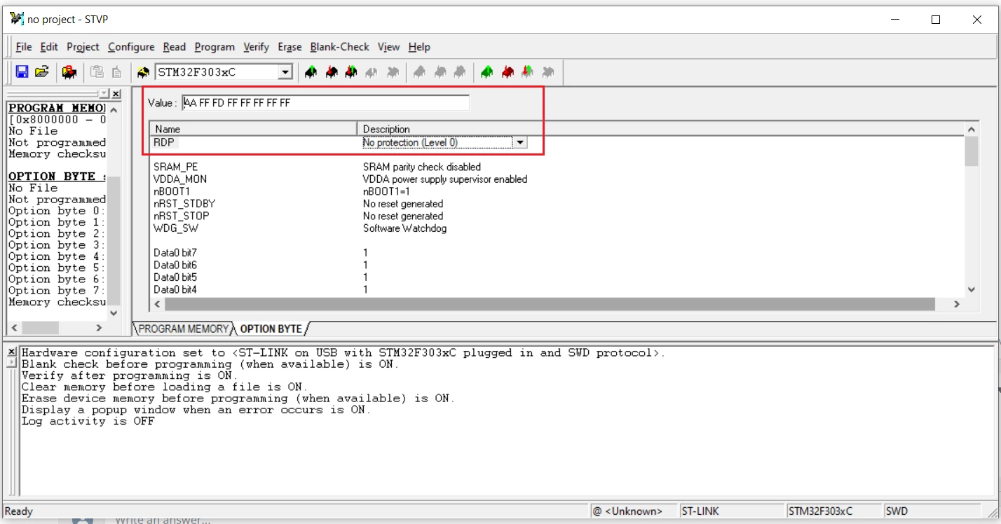

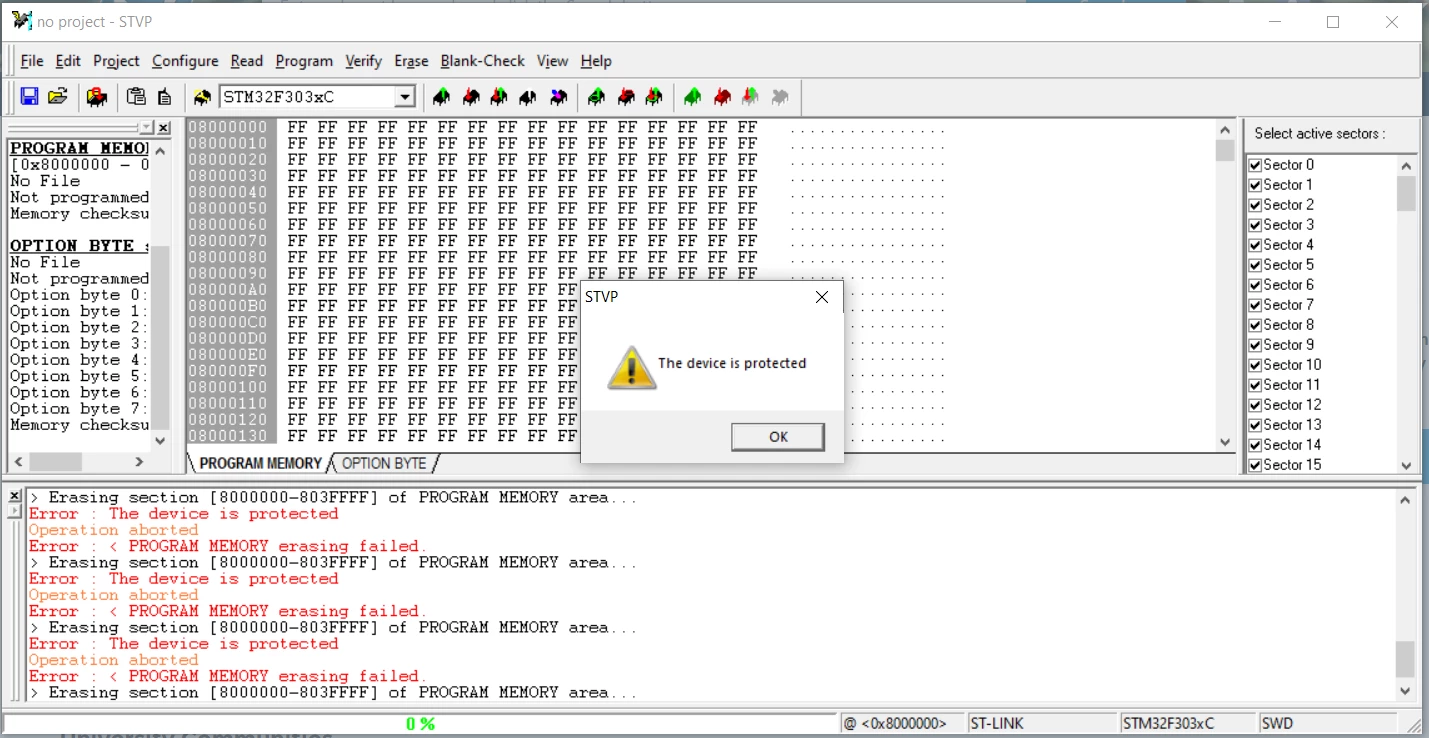

My MCU is loaded with the test program at the supplier. But when I loaded the actual program, it did not allow me to erase or read the chip, and the device was protected.

There seems to be some option bytes programmed to protect the example code. Probably it's RDP == 0xBB. Setting it to 0xAA will allow you to flash your code, but the original demo will be erased forever
TrungNguyen
November 14, 2019
I did that and still couldn't.

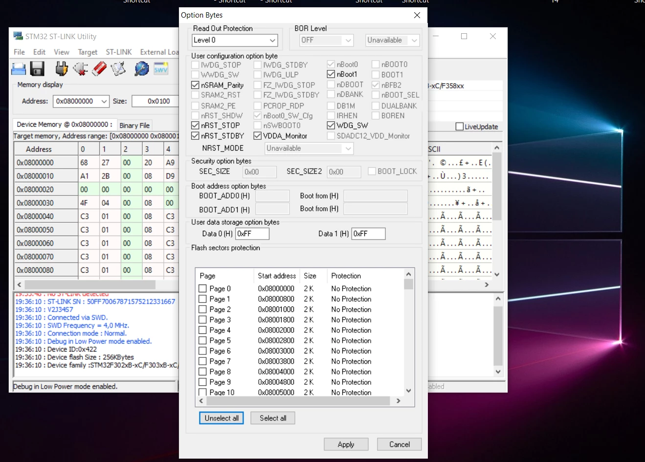

Tesla DeLorean
Guru
November 14, 2019
Very little detail of board or connectivity.
Could be a connection issue.
Please try using the ST-LINK Utilities or STM32 Cube Programmer applications.
Describe the board.
Had success with this previously, or new board/design?
Does mass erase clear the RDP state?​
