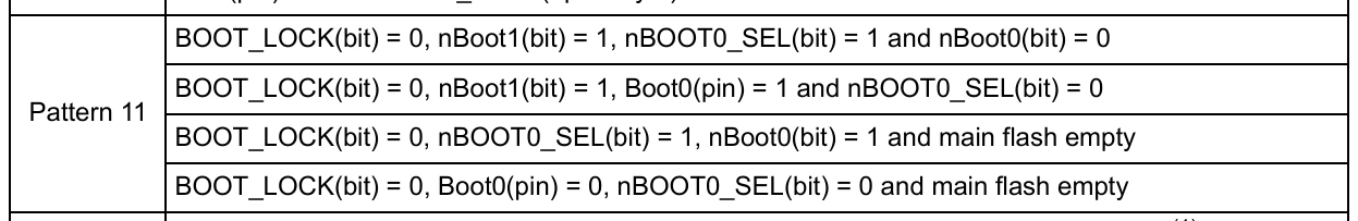

AN2606 is the correct resource which lists all of these answers.
Introduction to system memory boot mode on STM32 MCUs - Application note
Here are the ways to get into the bootloader. Check BOOT_LOCK bit.
Yes, PA2/PA3 are supported.

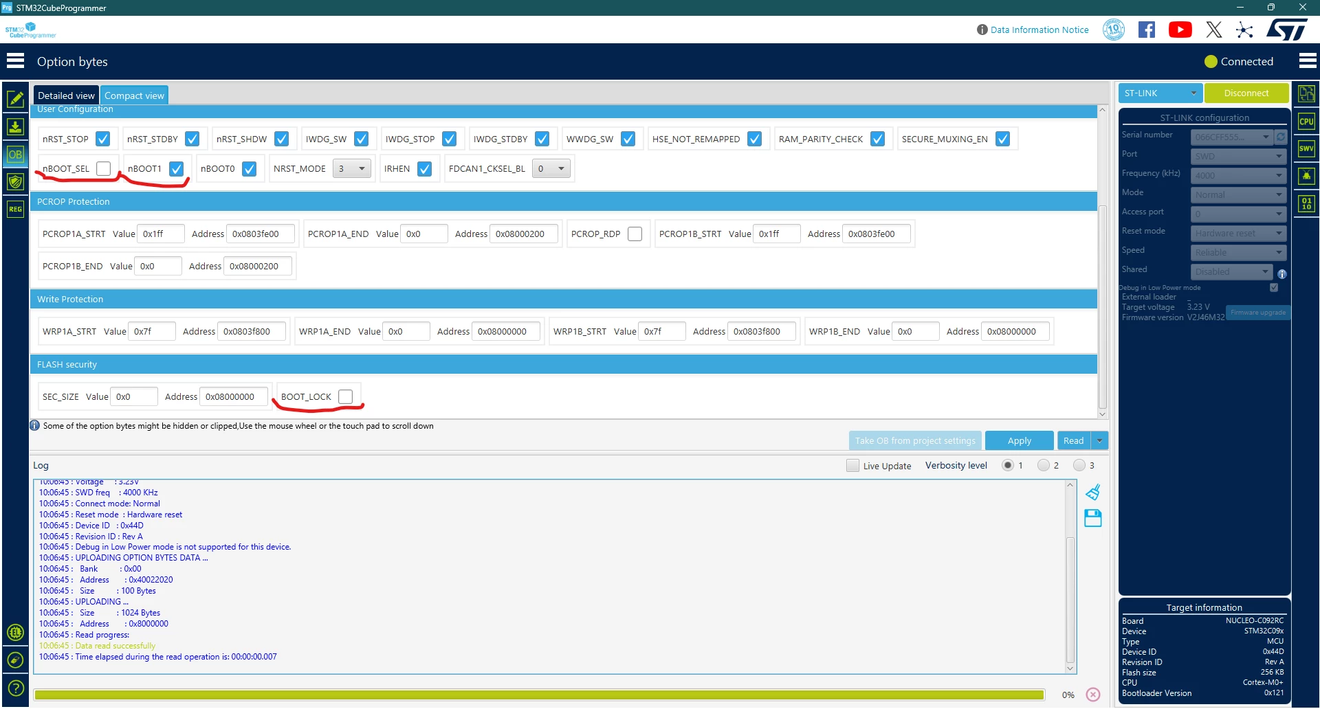

With STM32CubeProgrammer through ST-Link I verified:
  • BOOT_LOCK(bit) = 0 (it is the default value)
  • nBOOT1(bit) = 1 (it is the default value)
  • nBOOT_SEL(bit) = 0 (cleared by me)
 So, why System Bootloader does not start when I reset the NUCLEO with BOOT pushbutton pressed?
