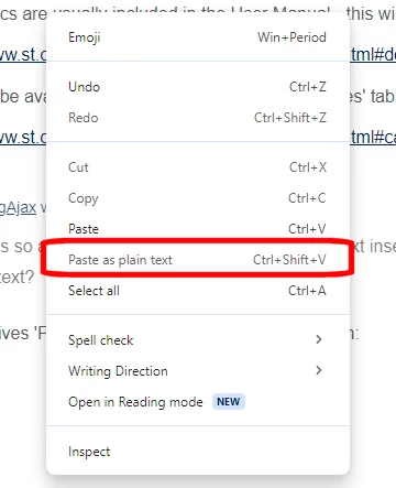

@OlegAjax wrote:
This is so annoying when press Ctrl+V and your text inserted in *** block in this form, how can I insert it as pain text?
That's a general Windows complaint, not specific to this forum; eg, you get the same pasting into Word - it pastes the source format, rather than whatever format you have already in the document.
Chrome gives 'Paste as plain text' as a right-click option:

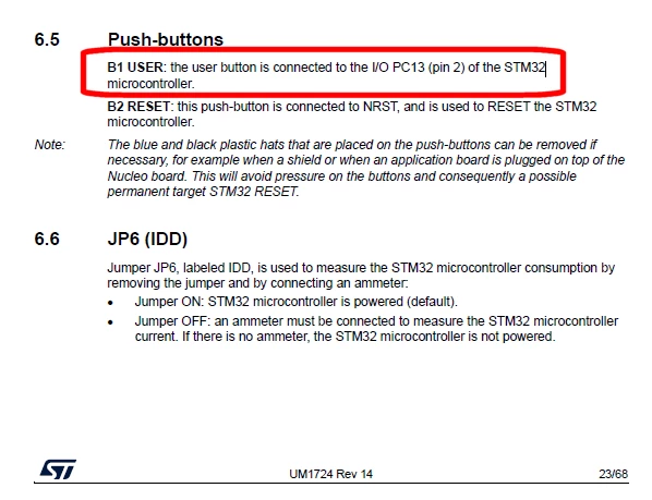

@OlegAjax wrote:
 to know, where button is connected
That will also be described in the text of the User Manual:

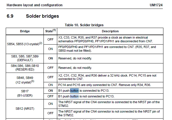

Also:
