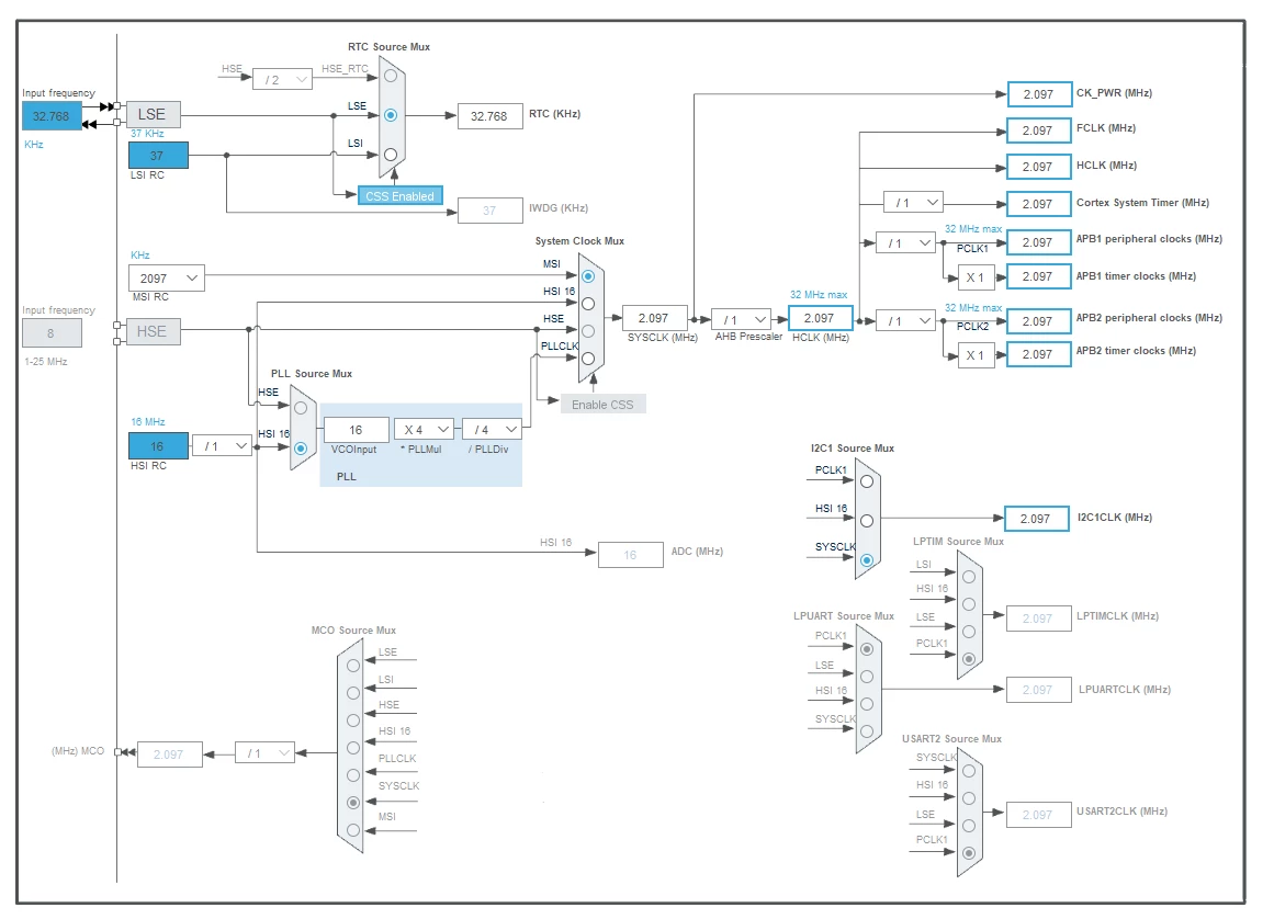

it seems my project hangs at this line ?
 Error_Handler();
What could be wrong?

Is this a custom board or known good hardware? Seems like you have a problem with the LSE connection.
You can try increasing the timeout value (LSE_STARTUP_TIMEOUT) to tens of seconds to see if it helps.
Edit:
Also, "hangs" is ambiguous. It is expected that the LSE will take some time to become stable. Does it return successfully after a few seconds or does it fail and return HAL_TIMEOUT?

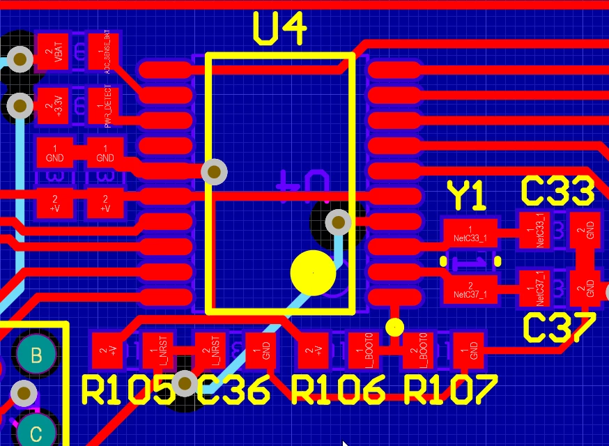

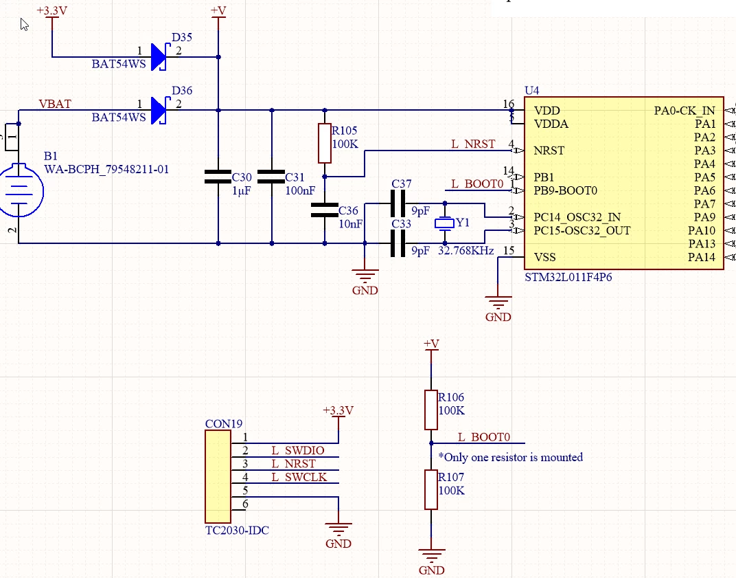

Its a custom board, i will show the schematic and PCB design.
increasing timeout does not help.
0693W00000GZDpfQAH.png0693W00000GZDpkQAH.pngAfter further investigation i see the Backup Domain Write Protection disabling goes in timeout.
Can't figure out why this is happening.
Any idea's?

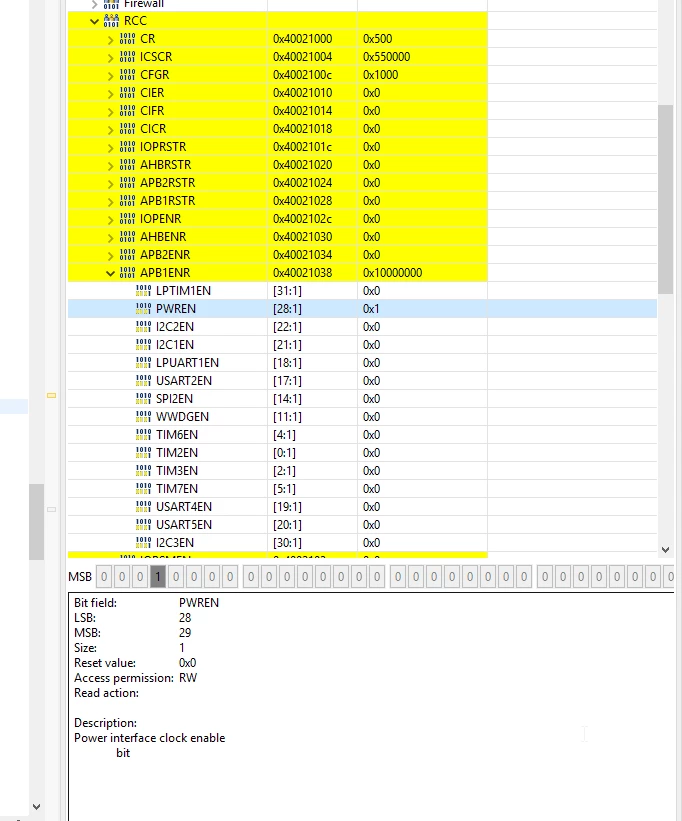

Is there a write to the DBP bit before the snippet you've posted?
Read out and check if RCC_APB1ENR.PWREN is set.

There is a write to PWR_CR_DBP before the snipped i posted, but the bit refuses to set
I notice that the external xtal is not running, (measure nothing on scope), does this have influence at that point of the initialisation?
Wondering why i dont measure anything, as this is a recommended part by STM. I have tried all "LSE drive capability settings"...
