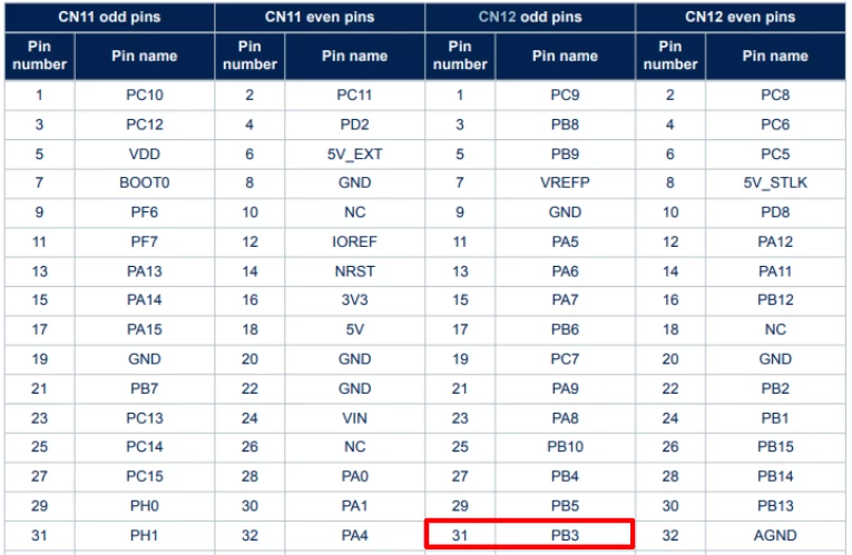

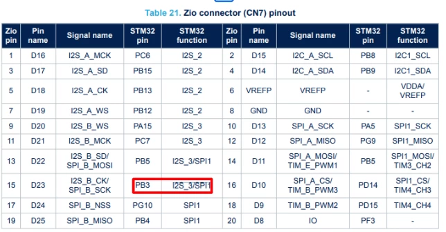

JuiHungAuthor
Mar 18, 2026 2:21 AM UTC
Hi FBL,
Thanks for the reply.
I have reconfigured the DEBUG mode from Serial Wire to Trace Asynchronous SW, which enables PB3 and regenerated the code.
I first tested with the USB ST-LINK port on the NUCLEO-144 board, and ITM_SendChar worked via SWV in STM32CubeIDE. Then I switched to ST-LINK/V2 and added an extra connection between Pin #13 on ST-LINK/V2 and PB3 on CN12-Pin #31 or CN7-Pin#15 on Nucleo-144 board, but the SWV output still does not show.
Is there anything I might be missing?
Thanks.
JuiHungAuthorBest answer
Mar 18, 2026 6:51 AM UTC
It turns out that the ST-LINK pin short needs to be removed from the power source select jumper JP2 on NUCELO-144. After removing it, the SWV output works correctly when STLINKV/2 SWO is connected to CN12-Pin #31.
