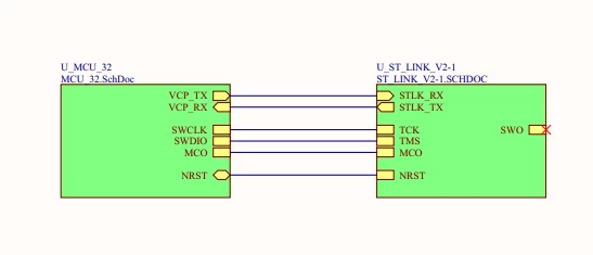

SWV can’t be used with nucleo-32 STM32F303K8
I am using nucleo-32 STM32F303K8 and want to graph variables with a debugger like this tutorial.
https://youtu.be/eumKLXNlM0U
Similar questions have been posted in the past.
https://community.st.com/s/global-search/nucleo32%20swv
SWO pins need to be connected to STLINK in order for SWV to display variables in a graph?
Looking at the circuit, SWO is not connected.
https://www.st.com/resource/en/user_manual/dm00231744-stm32-nucleo32-boards-mb1180-stmicroelectronics.pdf
