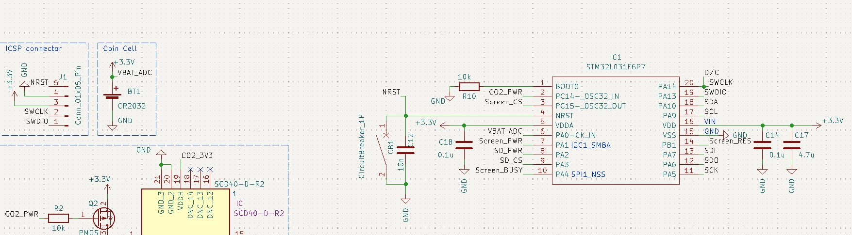

SWD Reset doesn't seem to work on ST-link
I am developping a custom board on stm32l031f6. I got my hand on a ST-link v2 (from what I searched today it seems to be clone dongle...). My application is tight on pin so I use SWclk as a GPIO pin. Before making this pin definition, I could freely  flash from STMCubeIDE. Now that I changed the definition for GPIO pin, when I flash, I kind of brick my MCU (expected).I thought that I would have been able to leverage the use of RST pin to automatically boot again my MCU, but even with trying "connect under reset", didn't do nothing.
Only way, I found is to manually push RESET, go on STMCubeProgrammer and full erase the chip, and after I can go back to STMCubeIDE to flash my chip. It is way too long in my workflow and I think a better solution exist since we only talk about pulling down a RST pin.
My hardware reset setup is as follow :
- NRST pin is tied to a button to ground (manual)
- NRST pin is tied to a header pin that is directly linked to ST-Link V2
- No pull up, pull down, cap...
So I have two questions, is my software/hardware setup correct (connect under reset is enough to automatically boot thanks to RST pin), is it normal that my MCU doesn't reset when I try to go on debug with connect under reset, active and Hardware reset on STMCubeProgrammer ? (I would have thought that even if it doesn't flash program at least my code would restart (I have visual clue when I manual reset))
Can my ST-link v2 dongle just broken ?? (It updated without issue, and since it has ST logo, I though it was legit...)

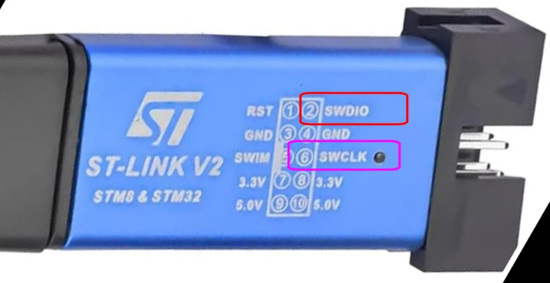

Clones dont have NRST signal for STM32. Google for howto add.
When you use GPIO you can only flash sw no debug.

1. if your  ST-link v2 looks like a USB-stick, its a clone. And has no working reset (for stm32).
2. You cannot define a debug port (swd, swc) as i/o port and expect it will still work with debug connection.
Decide, what you want: debug (st-link) connection or 2 more i/o ports , but no debug possible.
If you just want load your code from IDE, maybe try "connect under reset" setting and press and hold reset , when start "debug" or "run". (Or modify your clone, to have reset signal on "reset " named output. )
Or (as i would do) if you want use this ssop20 case, set debug pins for debug , connect setting "software reset" , and if tested your program and need no more debug, define the debug pins as i/o , as you like.

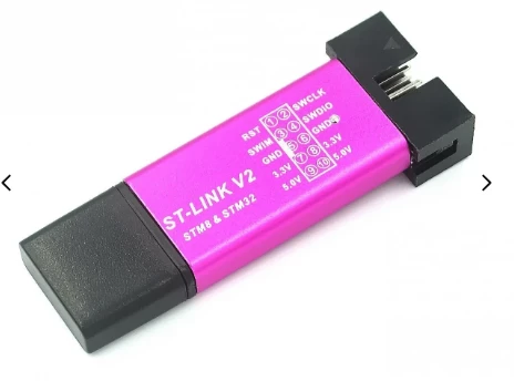

Andrew Neil
Jun 13, 2024 5:29 PM UTC
If it looks like this, it's a clone:
Even if it does have an "ST" logo on it:
https://community.st.com/t5/stm32-mcus-products/blue-pill-stm32f1-board-gets-programmed-through-arduino-ide-but/td-p/667923/page/4
unfortunately not.
Eymeric_Chauchat
Jun 14, 2024 2:14 AM UTC
Okay thanks to your answer, it was very helpful.
I managed to modify the hardware of my clone and use "Connect under reset" to be able to flash again from STMCubeIDE !
