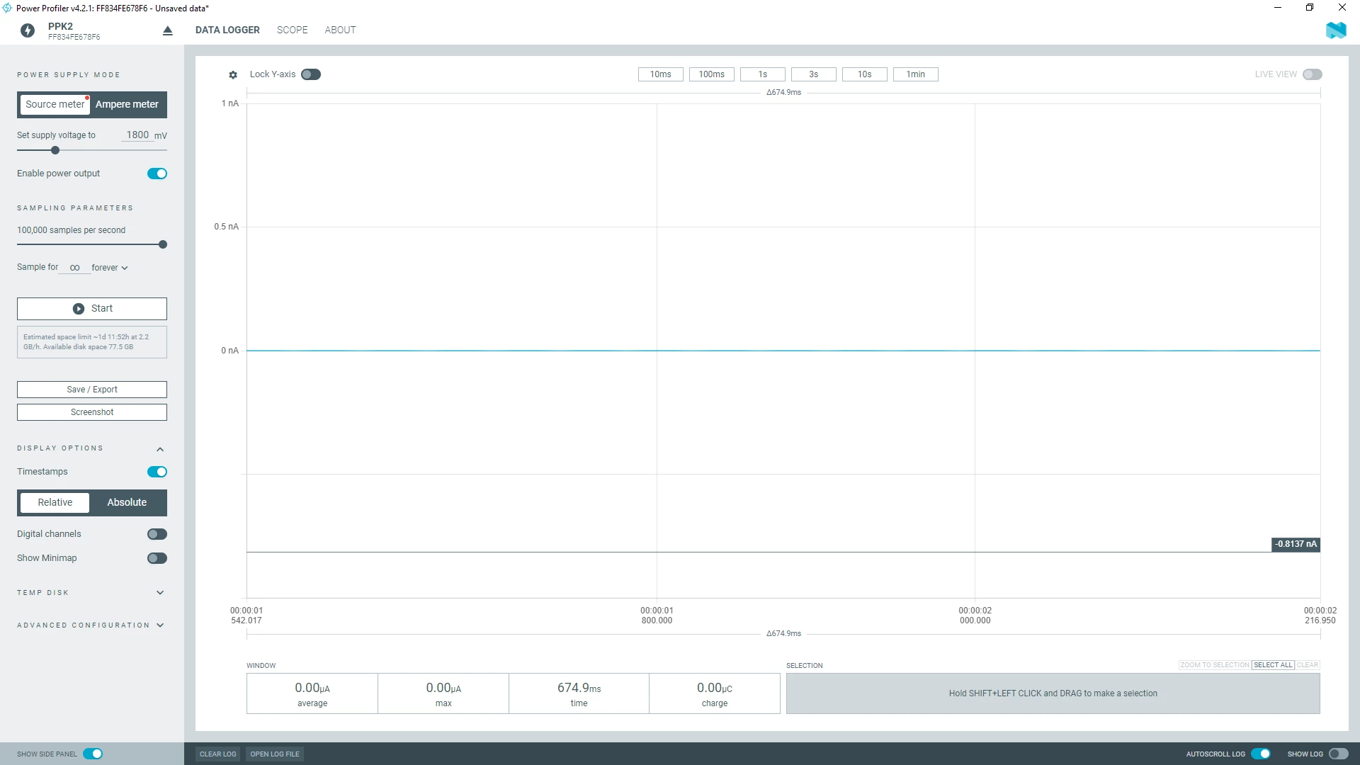

As indicate in the title I am trying to supply the MCU STM32L053R8 at 1.8V on the devkit NUCLEO-L053R8.
To do it I opened Jumper JP6, which purposes is to monitor current, and I deliver 1.8V on the VDD signal.

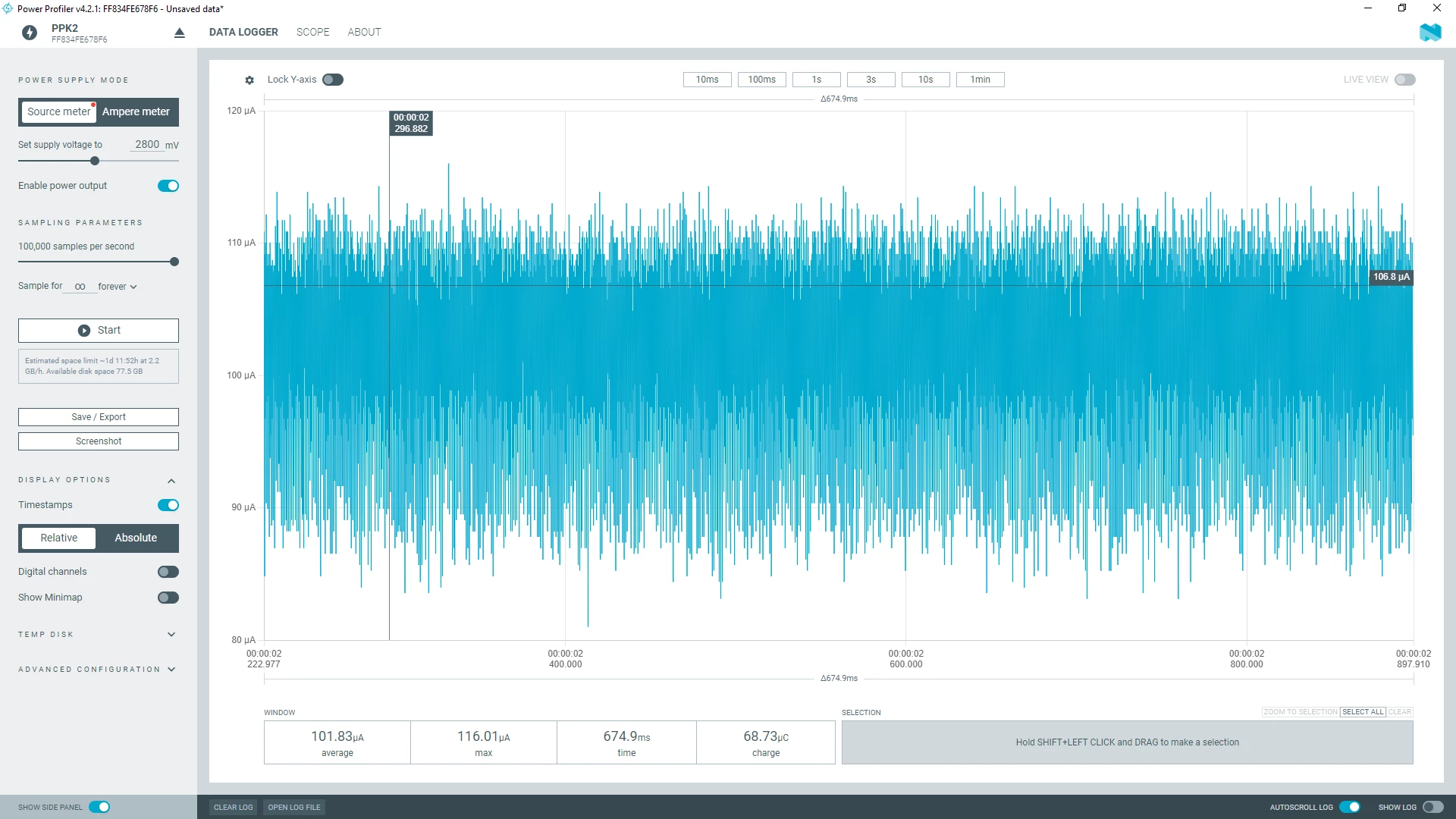

But the MCU is not working when I do that, my power supply is able to show me consumption and it stays to 0.
I need to level up at minimum 2.8V to see some current consumption.

I needed to unplug the USB_PWR connector so ST_Link does not turn on and open SB31 so current does not go to STLink through NRST signal.

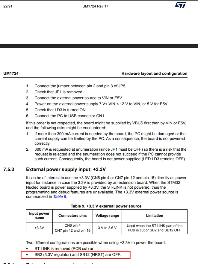

You need to study the schematics carefully.
I think the ST-Link works only at 3V, so you will probably need to disconnect it - in particular, the nRST signal from ST-Link to target.
It might be best to break-off the ST-Link section … ?
What’s the resolution on that ?
Edit: Never mind - I see it’s a Nordic PPK2.

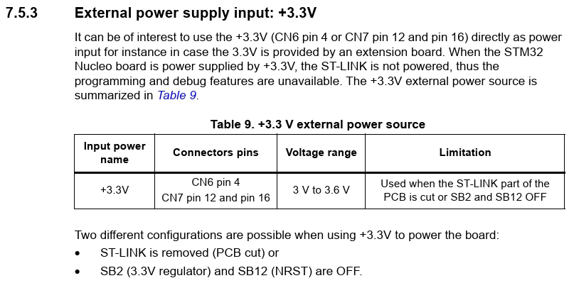

May also need to remove SB2:
https://www.st.com/resource/en/user_manual/um1724-stm32-nucleo64-boards-mb1136-stmicroelectronics.pdf#page=23
via: https://www.st.com/en/evaluation-tools/nucleo-l053r8.html#documentation

I was thinking about that because of this paragraph in the user manual but I was not sure it was related to my use because I am powering on VDD pin directly.
Anyway, thank you I’ll try that.
100k samples per second.
