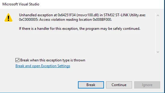

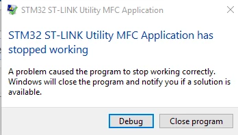

I have a new 32STM429I-DISCO board (with LCD). My first step is to download the demo program from the board to a file as I did not find that binary anywhere, so I could flash that back later. I tried to use the ST-LINK tool but it crashes (see details below)
A Linux tool https://github.com/texane/stlink under Ubuntu 15.04 64bit can detect the board but I am not familiar enough with that tool yet how to download the program form the board.
Thanks a lot for any help to accomplish my goals.
Windows 10 problem details
STSW-Link 004, Windows 10 64 bit. Selecting target=>connect, utility crashes. The driver in device manager does not shows any problems.
The DLL exists in C:\windows\system32.  Selecting ''debug'' shows this in visual Studio

Maybe a bit late to this, but which version are you using?
A colleague tried to use the STLink Utility v3.8.0 with a new Win-8 HP Laptop, and the utility would always crash on 'Connect to Target'.
v3.7.0 had no problems on a (nominally) identical Win-8 HP Laptop.
v3.8.0 could be made to work by setting Windows Compatibility settings for XP-SP3.
Maybe that helps someone ...
