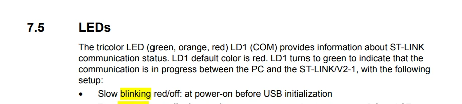

I am a newbie to STM32L432 boards. I am seeing that when i power the STM32L432 board with USB then everything is fine and my code runs and LED stays solid RED.
But if i try to start the STM32 board with only VIN i.e. +7V then the RED led i.e. LD1 keeps blinking. I have checked that i followed this -
This procedure also works fine -
1) Power up the board using VIN of +7V and LD1 keeps blinking.
2) Connecting USB then the LED LD1 turns to solid RED and then disconnect that cable after 5 seconds.
3) Then continue to use this.
I am guessing here that it is something to do with the bootloader not being able to run from Flash ? But how come just connecting the USB makes it run fine. Is this a known bug ?

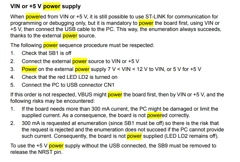

Which sounds a bit strange, but I suppose your board has an additional input for a DC power jack.
Mind you, the quoted document says "7V < VIN < 12V", which means +7V is the minimum required. I would try +9V, supposedly the nominal value.

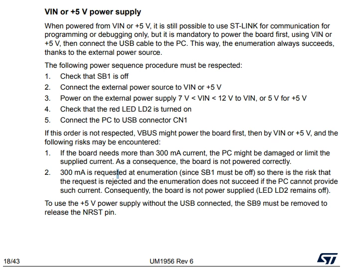

Andrew Neil
October 20, 2025
Welcome to the forum.
Please see How to write your question to maximize your chances to find a solution for best results.
You haven't said which Board you are using, but your screenshot looks like this:
https://www.st.com/resource/en/user_manual/um1956-stm32-nucleo32-boards-mb1180-stmicroelectronics.pdf#page=43
Which applies to the NUCLEO-L432KC Nucleo-32 board - is that the one?

October 20, 2025
This is the expected behavior. LD1 indicates a USB connection. If the USB cable isn't connected, the expected state is this will continue to flash red forever.

LED is LD1. It keeps blinking when i power up the device using VIN of +7V and code which i had programmed into it do not run.
LED LD1 stops blinking as soon as USB is connected and my code starts to run.
I would like my code to run when it is powered up by VIN which is around 7.3V
Dave001AuthorBest answer
October 20, 2025
This problem is already resolved by Solved: STM32L432 Nucleo-32 External Power - STMicroelectronics Community
Thank you all for Commenting. Much appreciated.
