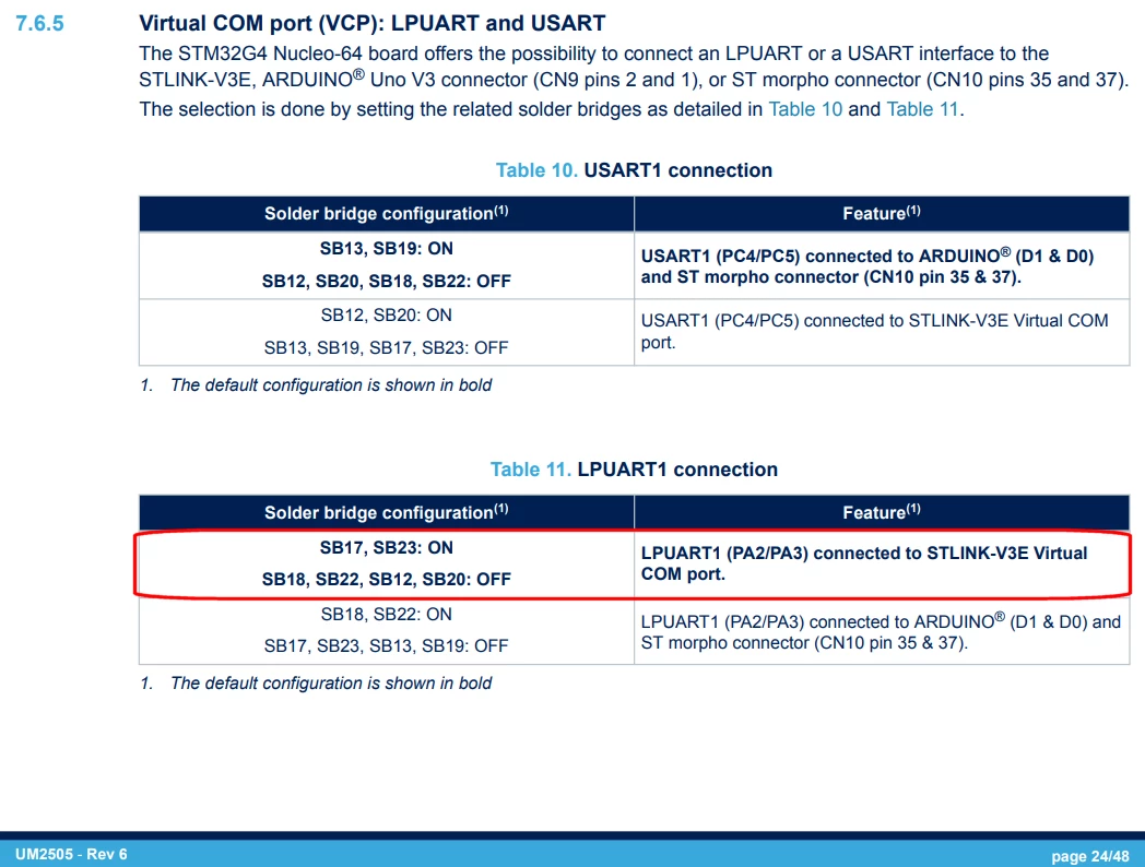

Andrew Neil
Jan 27, 2026 11:19 AM UTC
Before adding the complications of printf, have you got it working with a basic blocking HAL_UART_Transmit ?
Use this to prove basic connectivity.
Use ST's example specifically for the NUCLEO-G474RE.
@mpek29 wrote:
the data isn't hitting the ST-Link.
How did you test that?
If it is the case, it means you are using the wrong pins for your UART - which is a common mistake.
You must use whichever pins from the STM32 are physically connected to the ST-Link's VCP pins. - other pins will not work
To find which pins those are, see the board's User Manual and/or Schematics.
@mpek29 wrote:
I do this all the time with my NUCLEO-H723ZG using USART3 and it works like a charm.
Most likely, the H7 board uses different pins.
@mpek29 wrote:
For the G4, I’ve switched over to USART2, but no luck.
It's the pins which really matter!
Also check that your NUCLEO-G474RE hasn't been modified to disconnect the UART from the ST-Link.

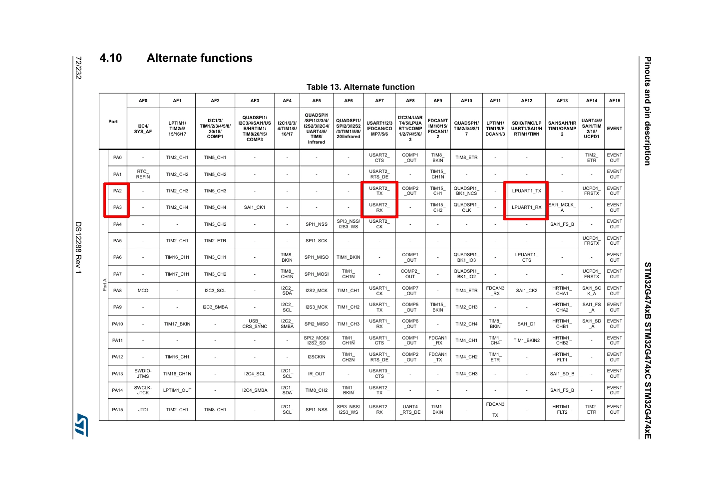

waclawek.jan
Jan 27, 2026 1:52 PM UTC
USART2 can be used at PA2&PA3 in the same way as LPUART1 can be.
Something has probably got lost in the clicking.
Debug as usually, by observing all relevant (RCC, USART, GPIO) registers' content (assuming you've checked the hardware already - pins connections, clock) and observing the waveforms on given pins using oscilloscope/LA.
mpek29AuthorBest answer
Jan 27, 2026 2:01 PM UTC
I’ve found the solution! It turns out I had mistakenly selected the wrong board/MCU part number during the initial setup in STM32CubeMX.
After restarting the project with the correct board profile and configuring LPUART1, everything is working perfectly. My apologies for the confusion, and thanks to everyone who took a look!
