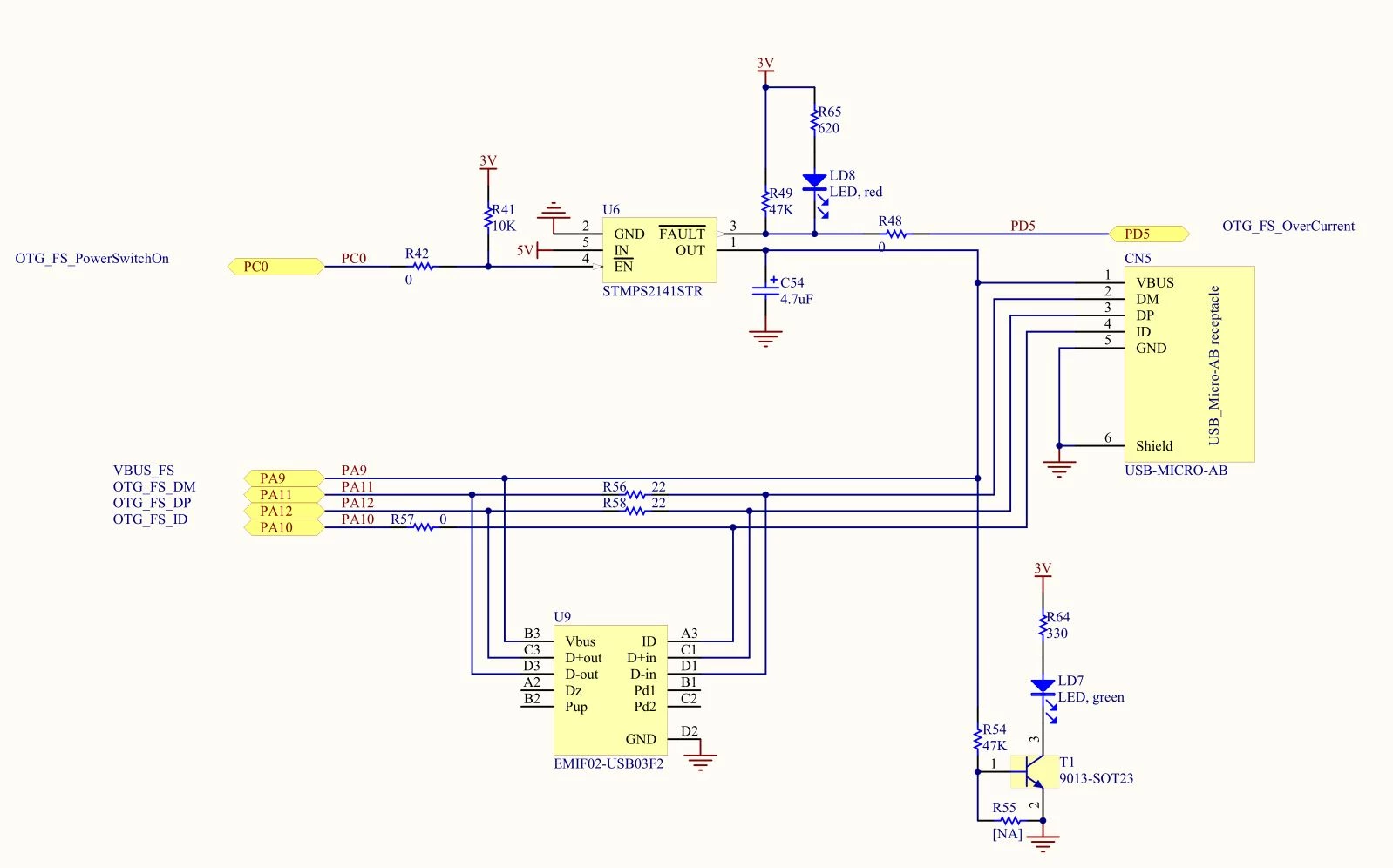

Struggling to get USB CDC device working with NUCLEO-F411RE directly connected to computer, but not with STM32F411E-DISCO
I have been struggling to get USB CDC device to work for the Nucleo without any additional USB peripherals. USB CDC works perfectly fine when I use the DISCO-board connected through the USB-micro, with the same MCU as the NUCLEO.

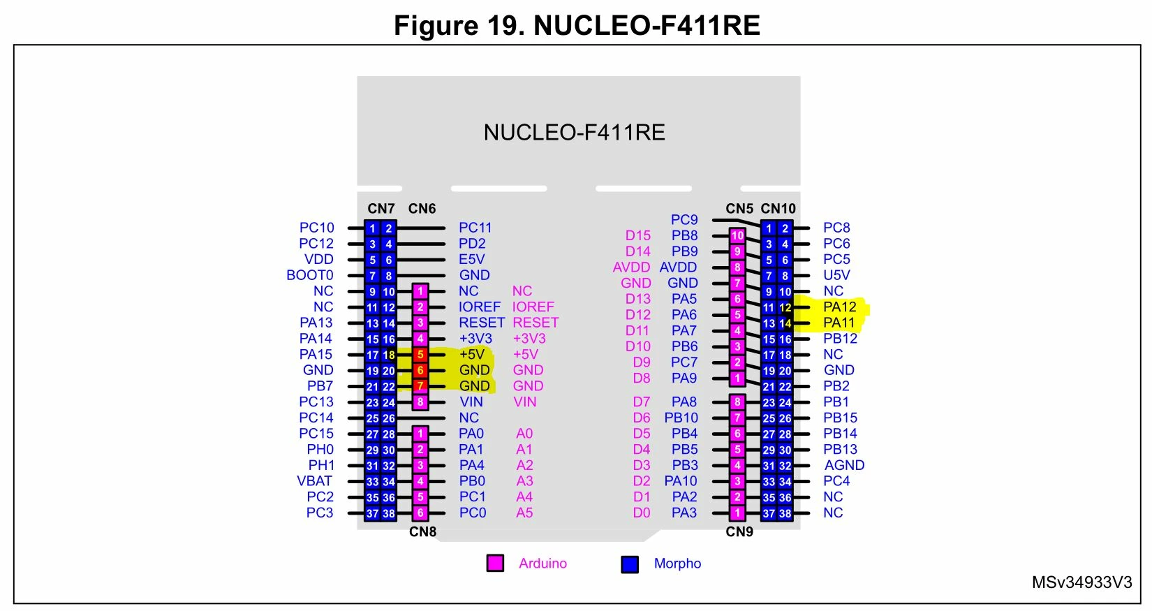

I have connected a cut USB A cable and using code like shown in this blog post (just other pin locations for the F411 compared to F042): https://shawnhymel.com/1795/getting-started-with-stm32-nucleo-usb-virtual-com-port/
I have tested removing the ground and shield connections as well as the 5V from the Nucleo, one at a time. When I connect the USB-cable to my computer I don't see any new devices in windows device manager. Why is the connection not recognized? Do I need additional resistors on the D+ and D- lines, when I want to set it up as device?

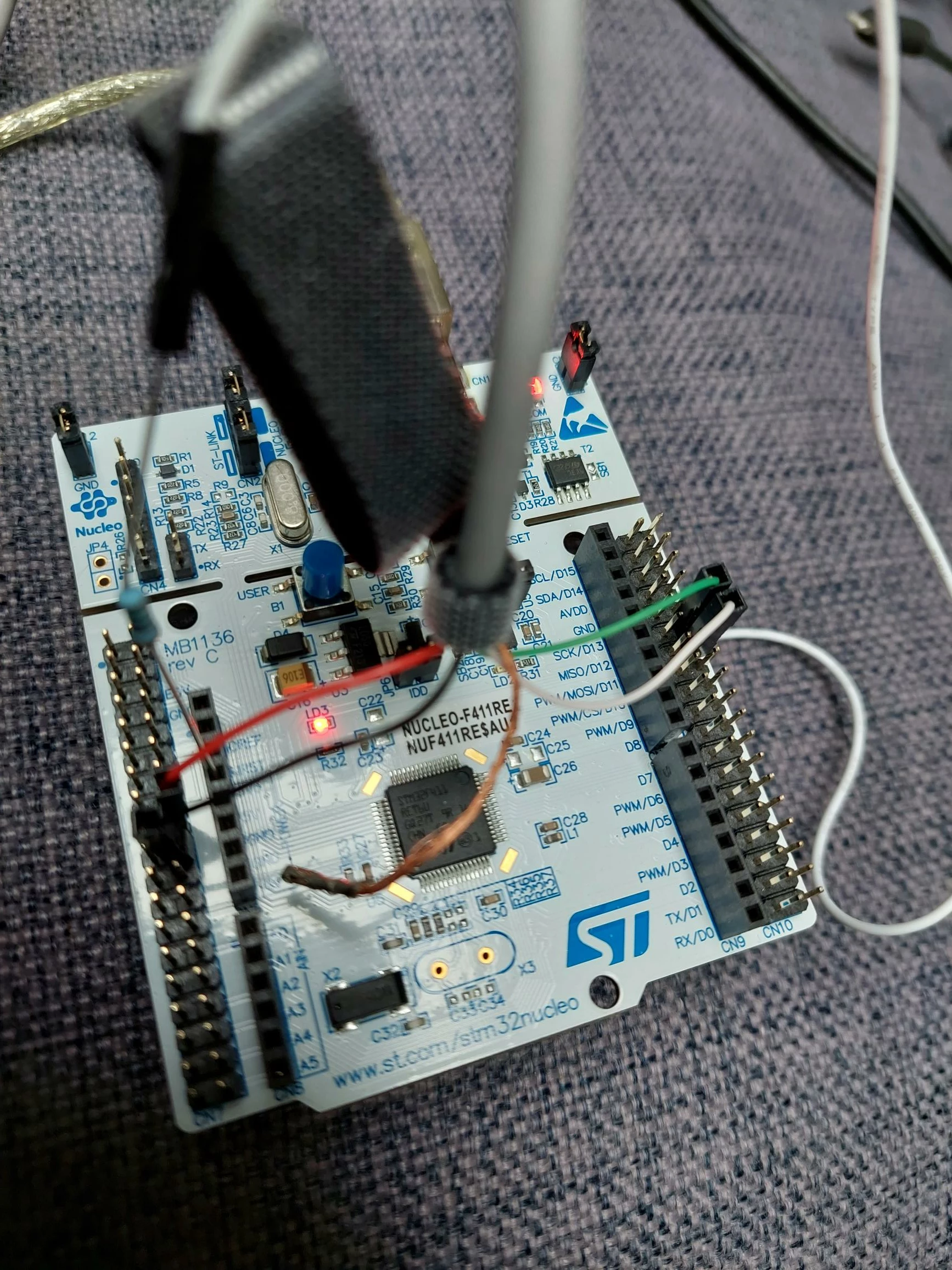

I found out how to make USB work with the NUCLEO-F411RE:
You need to couple the D+ (PA12) via a 1.5 kohm resistor to 3.3 V:
_legacyfs_online_stmicro_images_0693W00000bl3U1QAI.pngI now supply 5V and GND from the computer (red and black wire) and the resistor is connected from 3.3V to the pin on the other side of the board of where the green D+ wire is connected. You can leave the shielding disconncted or connect to GND.
By connecting the USB-cable this way I am able to power the board directly without any additional USB cable connected to the USB micro connector. This is not possible when connecting the red wire to E5V! Care must be taken though, as I don't think is a good thing connecting both the USB micro cable and the DIY cable simultaneously. The workflow would be to flash the board with the micro-connector connected and then unplug and plug in the DIY USB connector to the computer when powering and running the application.
