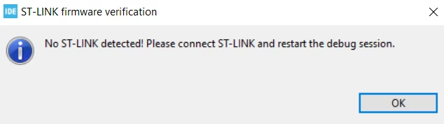

STMF334R8 not found in debug
When I try too start debugging I get this message:
0693W00000aJ8ESQA0.pngI checked the drivers and the device is showing as a USB Composit Device and I have no alternative to change the driver.
I installed en.stsw-link009 and successfully installed some drivers but they are not available in device manager.
I uninstalled the device in device manager but still no change.
I even installed the newest STM32CubeIDE 1.12.0 but still no change.
Does anybody have another idea?

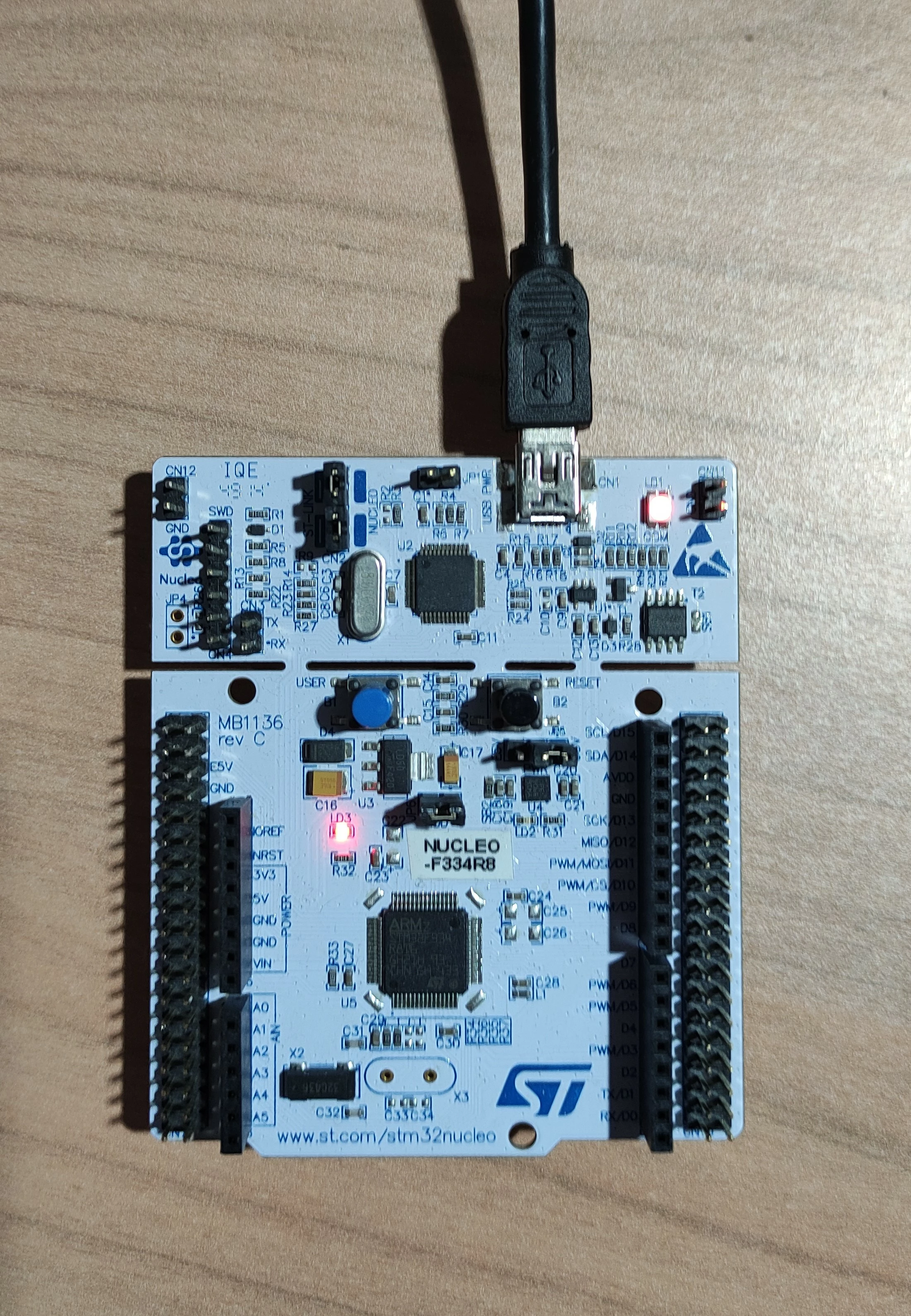

MLakc.1
MLakc.1Author
March 16, 2023
yes it's a NUCLEO-F334R8
now it's not connected so there is no light, when connected it has 2 red leds showing
Peter BENSCH
March 16, 2023

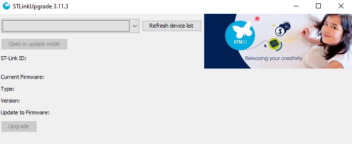

OK, please try to upgrade the embedded ST-LINK/V2-1 using STM32CubeIDE and the command:
Help > ST-Link Upgrade
MLakc.1
MLakc.1Author
March 16, 2023
It doesn't recognise the ST-LINK/V2-1
Peter BENSCH
March 16, 2023
The ST-LINK/V2-1 cannot be recognised because it does not receive any supply voltage.
Please set a jumper on JP1 (directly next to the MiniUSB socket).
Regards
/Peter

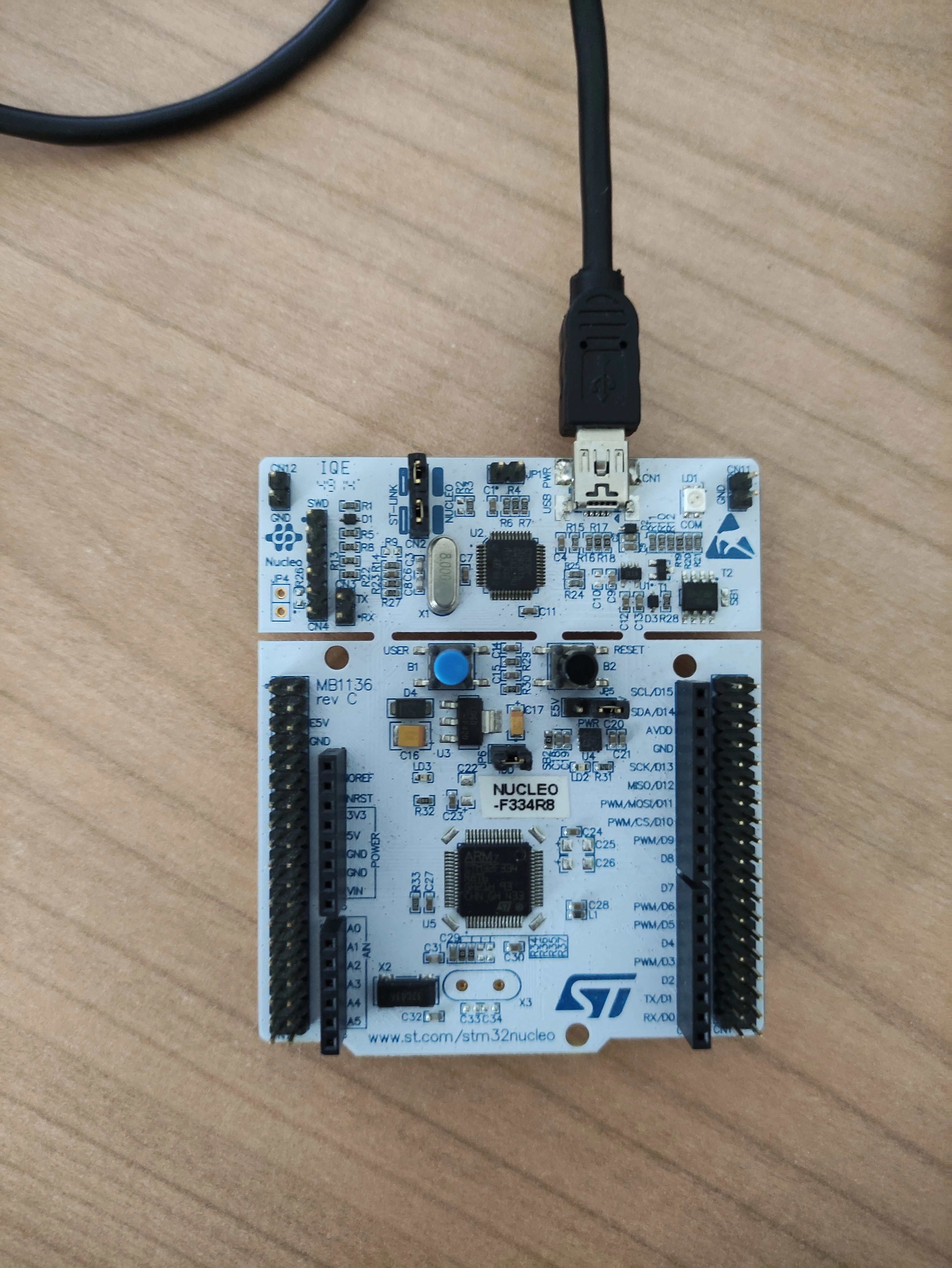

MLakc.1
MLakc.1Author
March 16, 2023
0693W00000aJ8RCQA0.jpgI don't have an extra one right now.
I recieved this device from somebody and it already has some jumpers:
  • 2 on the two gnd connections on the bottom
  • 1 in IDD
  • 2 in CN2 - it says st-link on the side
  • and 1 in PWR
can I remove any of these?
Peter BENSCH
March 16, 2023
The two GND jumpers at the bottom are spare ones, your can easily take any of them.
Peter BENSCH
March 16, 2023
Sorry, I made a mistake - the supply voltage does not route via JP1, but is connected directly to the STM32F103. So you can disconnect it again and set the jumper back to the bottom side.
The other jumpers were set correctly (PWR = U5V, IDD = set and 2 jumpers on ST-LINK).
If the USB port on your computer works otherwise, there are now only two possibilities: the USB cable is defective or the ST-LINK has been damaged.
Regards
/Peter
