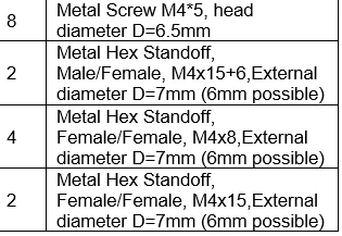

Hi all,
I have this kit but I don’t have any bolts holding the display PCB to the main PCB. I tried to look at the BOM for a reference to the part number but I don’t see anything for the bolts. I took one of the bolts holding the standoffs to the main PCB and it looks like an M4mm x 0.5 but I rather be sure before I order a few online. I have enough stuff that doesn’t match them and I rather not add more :-).

Here is the list, I guess the answer to your request is in the 3rd row:

Where did u find this info? Did I miss it in the BOM? It looks like it would be the first row. Thanks a lot!!

You did not miss it, it is not publicly available.
