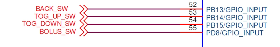

I'm using the STM32U5G7VJT6Q microcontroller to read input from a few switches. All switches should show a high state when unpressed (due to the pull-up resistor) and a low state when pressed (grounded).
However, one switch is acting strangely:
  • When it's unpressed, it stays in a low (reset) state, but it should be high.
  • It only changes to high when another switch is pressed.
  • The other switches are working fine.
  • The switch is connected in the following order: TVS diode -> Pull-up resistor -> RC filter -> GPIO pin.
  • The GPIO pins are set as inputs with internal pull-ups enabled.
  • The wiring looks correct, and the pull-up resistor is in place.
  • The other switches behave as expected.
  • Tried removing the tvs diode and capacitor in rc as well, still the same behavior occurs
Note: No input of the switches are shorted or grounded, the behavior is observed in all the boards we fabricated.

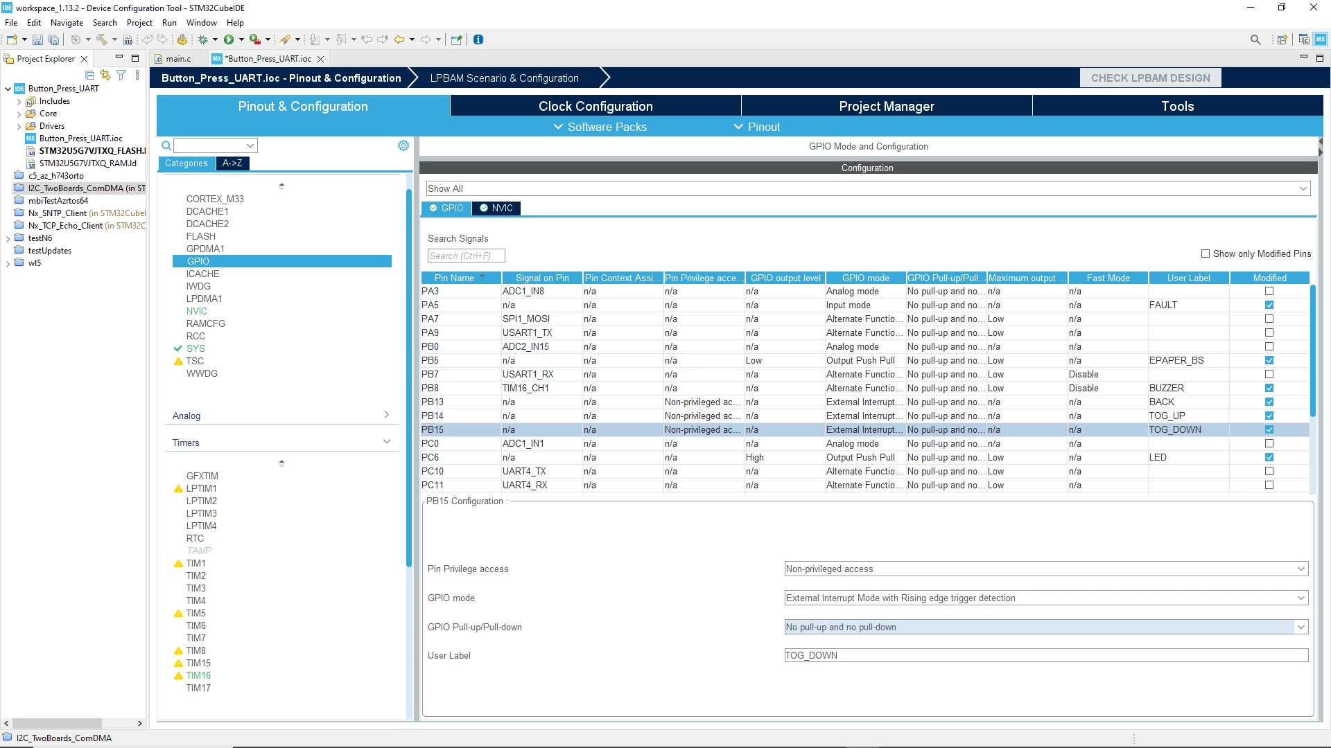

The issue is with Tog_down_sw. it is in floating state even when pulled up both internally and externally (no other passive components inbetween). when tog_up_sw is pressed tog_down_sw goes low.

I took your .ioc and created a new project.
This is how your GPIO are setup.
There is no pull up selected and inputs are driving interupts !
Any noise is detected.
These inputs acr CMOS, that means that they can take any state (thanks to internal capacitative coupling) of any internal register or signal line.
