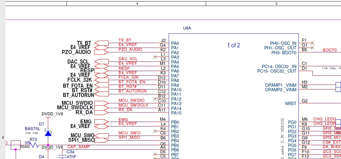

Ephraimoved
December 13, 2022
Hi
We are getting close , attched a pic
See PZO_AUDIO is the positive into PA2 .
E4_VREF is the negative into PA1 .
Should I swpa the pins ( by hardware ) or any workaround in software ?
Please Advise
waclawek.jan
December 13, 2022
Instead of posting code/link to code, read out and check/post content of ADC and relevant GPIO registers; and describe what's your related hardware, how do you observe the "is not working well" state and how does it differ from your expectations.
Also note, that in STM32, ADC in differential mode has a very restricted common-mode voltage.range.
Jaroslav JANOS
Jaroslav JANOSBest answer
December 13, 2022
OK, so "getting close" means that there is some output of the ADC, which is not correct?
If you can swap the inputs on the PCB, do it. Otherwise you will need to compute the correct value in software.
BR,
Jaroslav
Ephraimoved
December 14, 2022
Hi.
It works fine , Many Thanks
