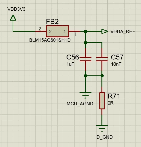

I suspect a ground loop might be the fault. How is the board powered, how are grounds isolated?

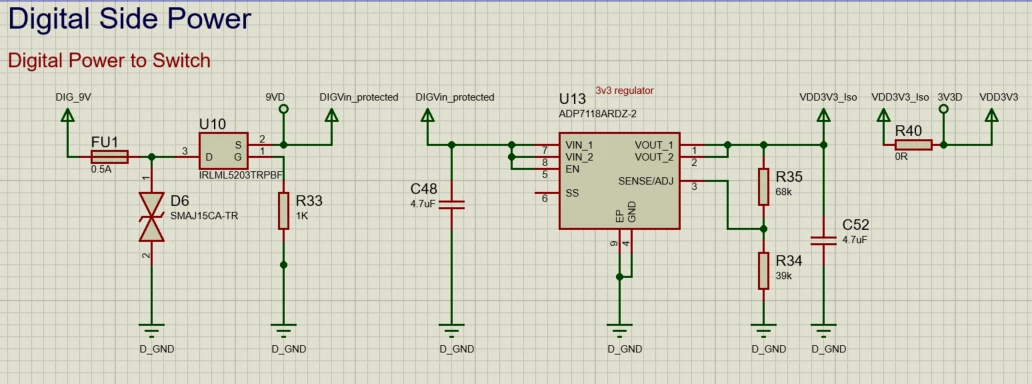

10 uF cap on NRST is way too high. Should be 0.1 uF. I'm not sure if this will cause issues. Is VDD decoupled? Is VDDA connected to VDD? Lots of details we can't see in the portion of the schematic you sent. Consistent issues with chips shorting suggest a protection diode is getting blown. Is VDD stable? Generated from an LDO?

Thank you very much for your responses, @Tesla DeLorean I've checked the pin out on the JTAG connector and it matches the pins on the JTAG schematic so I don't suspect its that. With regards to the PC13, that a GPIO logic input of 3V to 0V, so nothing is being driven from it.

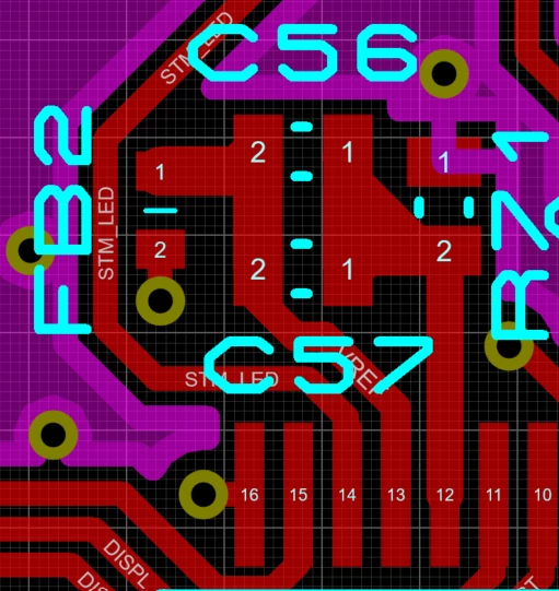

The power supply is a stable 9V, which is protected and then passed through a LDO to drop it to 3V3, I've attached the schematic for the protections and LDO implementation, and I have attached the schematic for the VDD and VDDA isolation @TDK. There may be an issue there, but I have followed the recommended layout from the data sheet.
