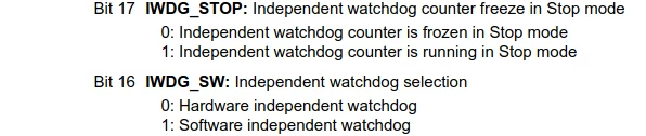

Can I use the IWDG in STOP mode? I see that bit 17 of the FLASH_OPTR register is used to stop the IWDG counter in STOP mode.
If this is possible, could you suggest the necessary steps? Watchdog and low-power functionality are essential for my product.

Oct 24, 2025 9:34 PM UTC
Hi @STackPointer64 ,
My idea is to freeze the Independent Watchdog (IWDG) counter in STOP mode so that the MCU will not reset due to the IWDG counter elapsing.
From my understanding, this can be achieved by clearing bit 17 (IWDG_STOP) of the FLASH_OPTR register, if I am right.
As per the reference manual, in STOP mode, the IWDG can be automatically frozen depending on the configuration of the IWDG_STOP bit in the FLASH_OPTR register.
So, the IWDG should not reset the MCU during STOP (sleep) mode, correct?
If both assumptions are correct, could you please share the steps or example code to:
  1. Configure the IWDG to operate (or be frozen) in STOP mode, and
  2. Set up the FLASH_OPTR register appropriately for this behaviour?
Oct 29, 2025 3:00 PM UTC
Hello @suresh kumar1,
Yes, that is possible by unchecking the IWDG_STOP option byte in STM32CubeProgrammer after connecting to the board.
As for example code demonstrating IWDG operating in stop mode, there isn’t any for this specific use case. However, you can check the following examples and draw inspiration from how IWDG is implemented in them.
