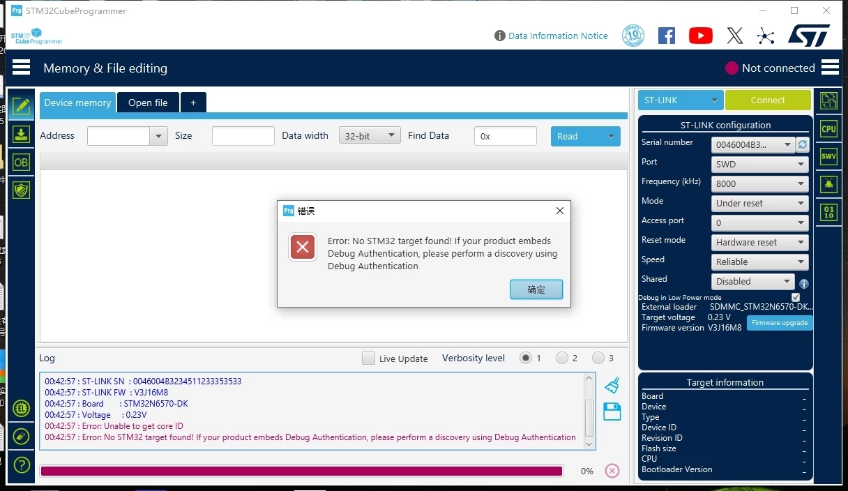

STM32N6570-DK,Unable to connect using STM32CubeProgrammer software ST-LINK, target not found

STM32N6570-DK STM32CubeProgrammer,Unable to connect using STM32CubeProgrammer software ST-LINK, target not found,Error: No STM32 target found! lf your product embedsDebug Authentication, please perform a discovery usingDebug Authentication
How to solve it

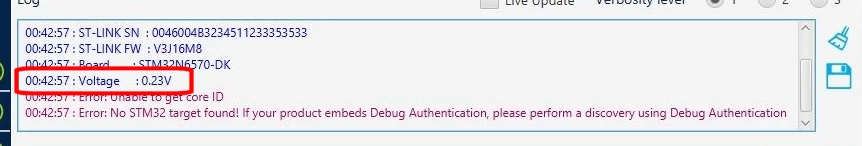

Target Voltage: 0.23 V
This is insufficient voltage to power the device. Look at the user manual for how to power the device properly.

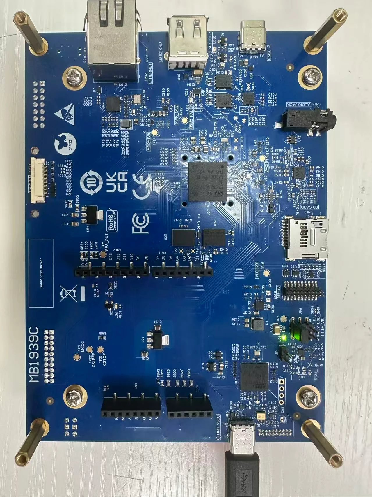

Hello, how to set the voltage? I don’t understand the manual. How much voltage is needed to be adjusted to connect to ST-LINK normally

As @TDK said, you have no power on your target:

Hello, how do you need to restore normal operation? I don’t understand the manual very well. Is there any specific method? thank you
