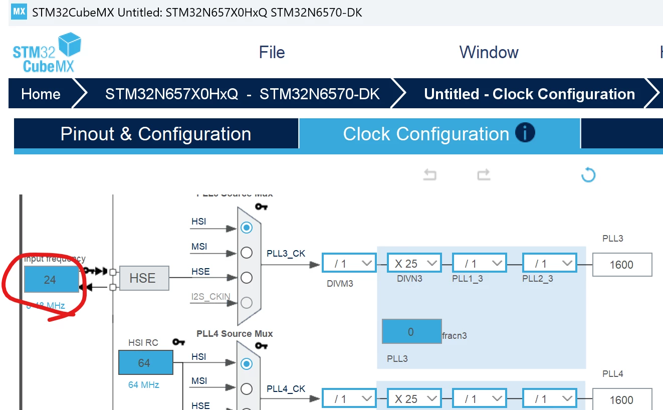

I am currently evaluating the STM32N6570-DK and am seeking clarification regarding a discrepancy I’ve encountered.
I can confirm that there is a 48MHz crystal on board for the HSE. However, the default CubeMX projects generated by the board selector, as well as other example projects I have reviewed, all configure the input frequency to 24MHz.
Could you please clarify what the correct input frequency for the HSE should be on this discovery kit?

Simon V.
Jan 26, 2026 5:00 PM UTC
Can you please share which projects please ? I performed a quick check on template project for example and HSE frequency was 48MHz.
Please note from product reference manual HSE peripheral has an optional DIV2 output.
Regards,
Simon
Jan 26, 2026 5:16 PM UTC
A default project created on the board for me shows 24 MHz, not 48 MHz. Maybe templates are correct, maybe not. The result is still wrong.

mhd0425Author
Jan 26, 2026 5:28 PM UTC
@Simon V. The projects are from Infineon AIROC https://github.com/Infineon/AIROC-Wi-Fi-Bluetooth-STM32 but also when I generate a project from board selector. CubeMX 6.16.1 and MPU package for STM32N6 Series version 1.3.0.
I checked the crystal under a microscope. It is labeled 48MHz.
@TDK That is what I see too.
mhd0425Author
Jan 26, 2026 8:33 PM UTC
I believe this confirms the HSE DIV2 path. However, this might also be incorrect considering the HSE input frequency is actually 48MHz.
Could you please review this and let me know your thoughts?

Simon V.
Simon V.Best answer
Jan 27, 2026 8:02 AM UTC
I confirm that default template for both N6 DK and N6 Nucleo are wrongly generated using a base frequency for HSE=24MHz. I forward this update request to CubeMx internal team for correction.
Thanks for your input relative to this typo.
Regards,
Simon
