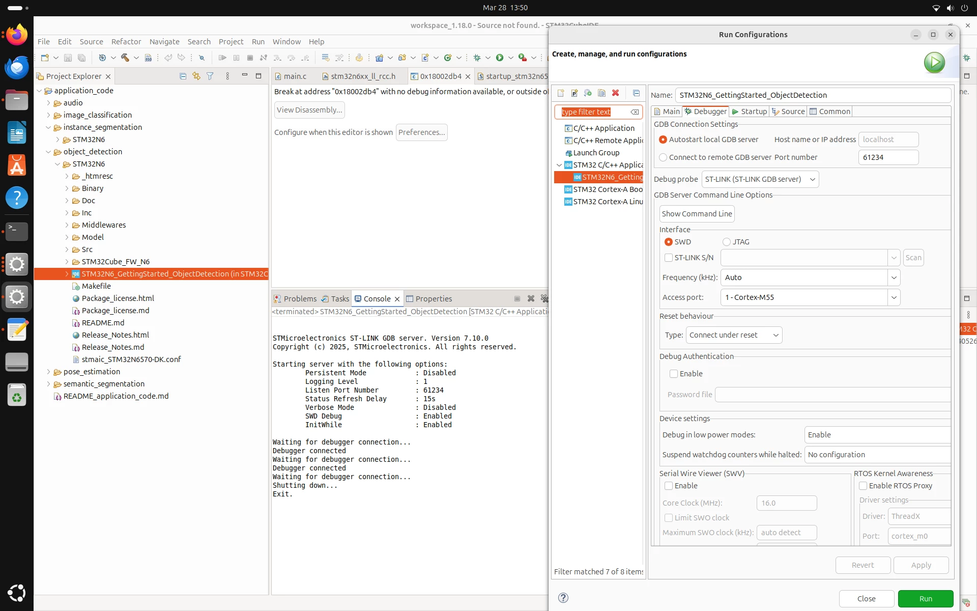

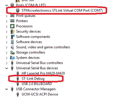

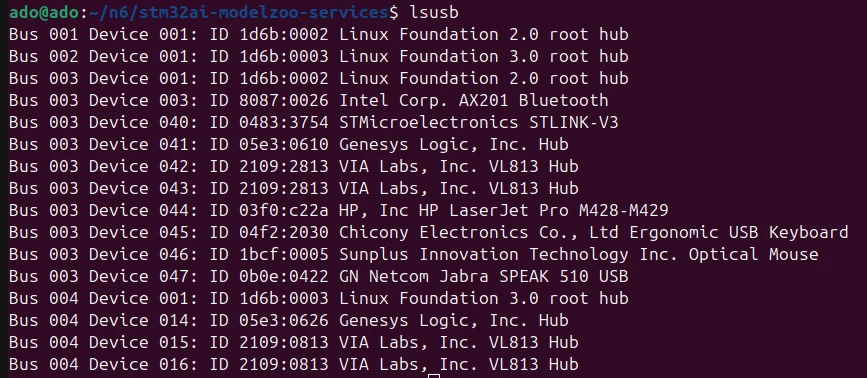

Mar 28, 2025 2:40 PM UTC
I thought power was my STM32N6570-DK problem too, but it seems not.

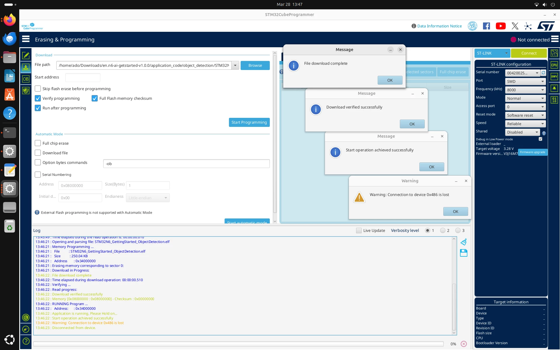

I have been trying to flash the n6-ai-getstarted demos seperately to the default shipped AI demos just to see it works.
 STM32N6-AI - AI software ecosystem for STM32N6 with Neural-ART accelerator - STMicroelectronics
Tried on both Linux/Ubuntu and Windows with both CubeIDE and CubeProgrammer.
Drivers/usb seem fine but i keep getting a "Connection to device lost" on CubeProgrammer or "Waiting for debugger connection" errors when i try to flash N6 with new application so its not programming any new applications.
Tried with JP2 at position 1-2 and 3-4 with all different USB cable types too.
Happens when i select "Run after programming" on CubeProgrammer or hit B1 (Reset Button on DK).
Verbose CubeProgrammer Log attached, Any ideas ?
See at end of log "14:33:17:828 : Warning: Connection to device 0x486 is lost"
thanks

it seems that power was your STM32N6570-DK problem too.
Did you power the board via USB-C to USB-C cable from your PC(or USB-C charger) and ensure it can provide >=2A current ?

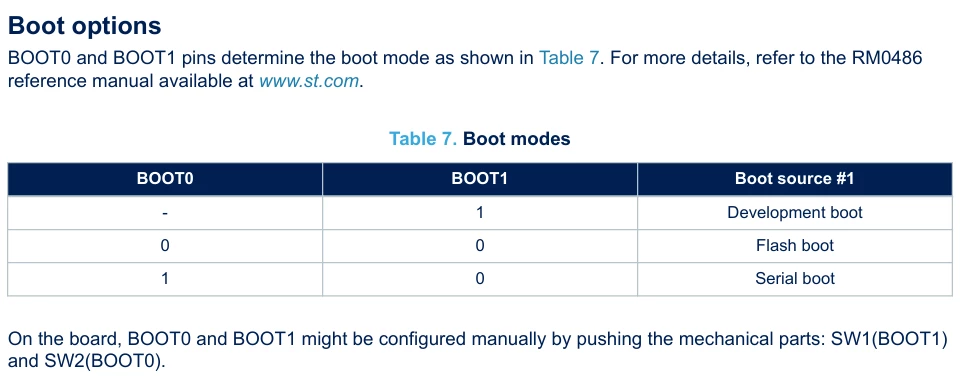

Yes, im supplying >=2A on  USB1(CN18) and JP2 is at position 3-4 as per doc.
Discovery kit with STM32N657X0 MCU - User manual
Please suggest best boot option for starting ?
And, Maybe taking a step back, where should i be starting, running these examples below ?
STM32CubeN6 - STM32Cube MCU Package for STM32N6 series (HAL, CMSIS devices, and examples running on ST boards) - STMicroelectronics
or these ?
jiangfan
Apr 1, 2025 1:45 AM UTC
Flash boot is used if board correctly flashed when user wants to try a new example/demo etc.

Apr 9, 2025 8:35 AM UTC
Hope that all worked, for me , one thing that threw me was when following this README to load the object detection to the DK,
stm32ai-modelzoo-services/object_detection/deployment/README_STM32N6.md at main · STMicroelectronics/stm32ai-modelzoo-services · GitHub
and it says
"3. Set the switch BOOT0 to the right (dev mode) and disconnect/reconnect the power cable of your board."
i believe it should say BOOT1 and not BOOT0 ?
