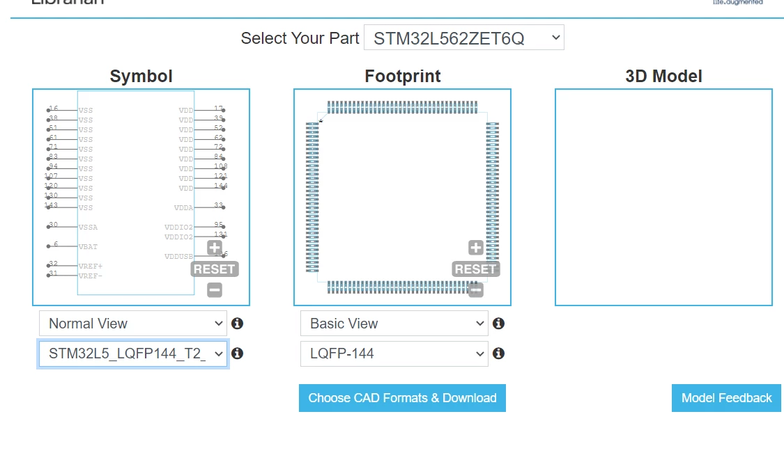

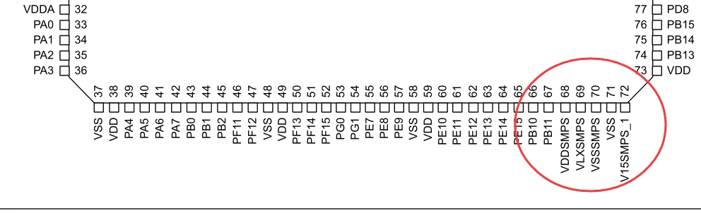

STM32L562ZET6Q CAD symbol wrong
0693W00000BaG2sQAF.png0693W00000BaG24QAF.pngI used stm32l562zet6q in my item,i found in product page zet6q cad symbol is same as zet6 but in datasheet is not.

Yes, as far as I know, SMPS "Q" version have different pinout.
Please click "Model Feedback" on the website and explain the problem.
I did as well.
