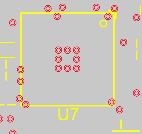

Drill for U7

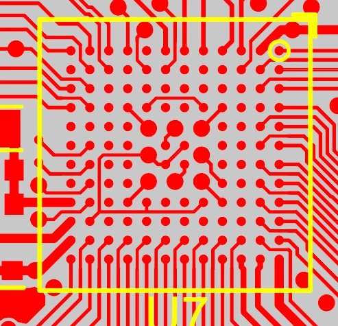

Top Layer layout for U7

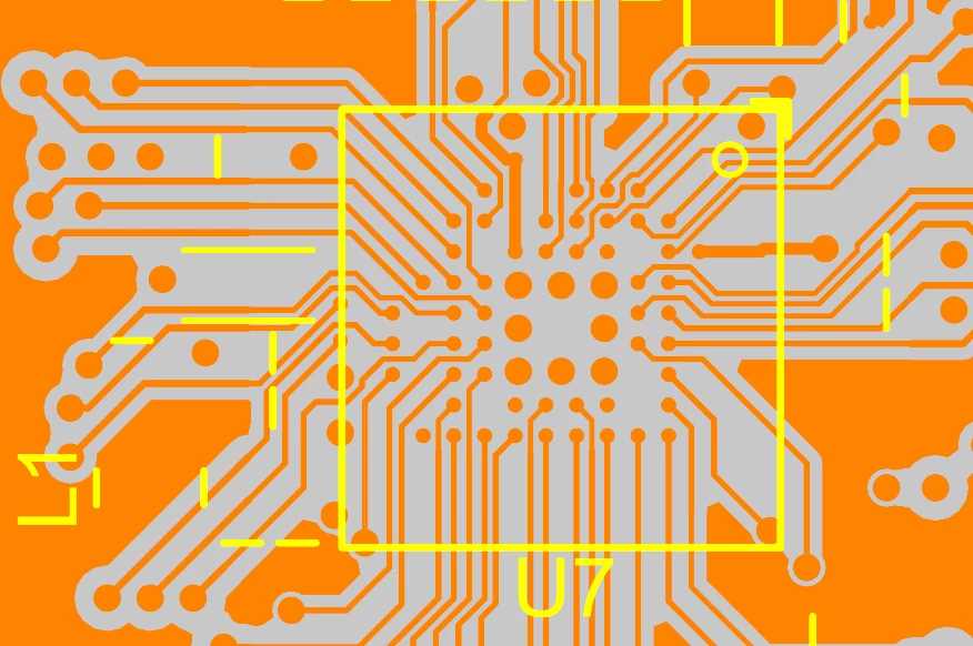

Sig 1 layer layout for U7.

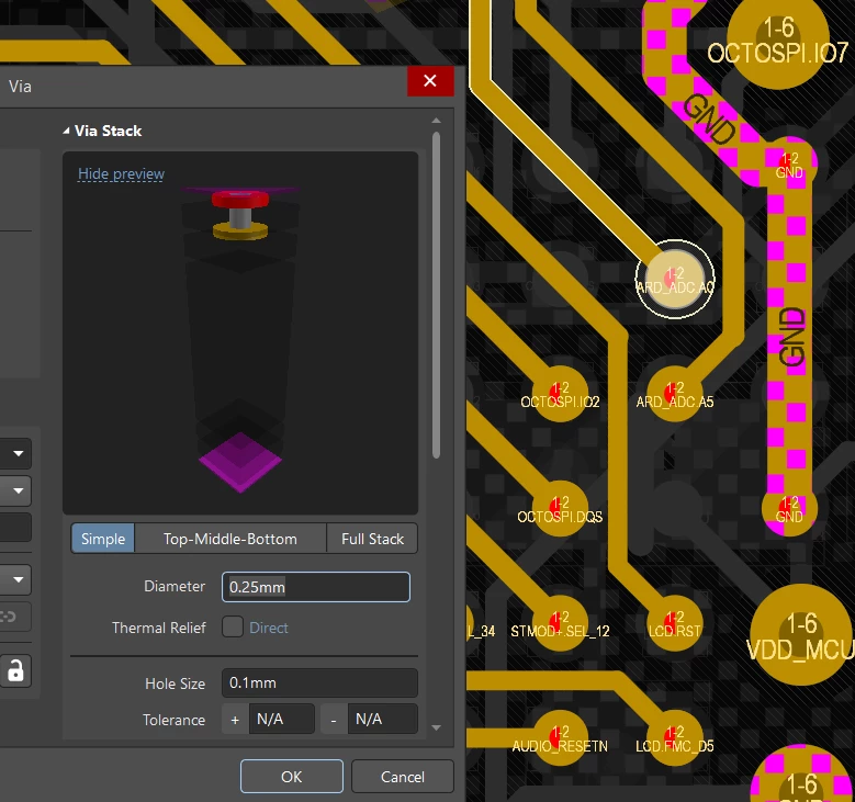

Hi
According to the PCB file of STM32L562E-DK, the via between top layer and S1 layer blind via, whose diameter is 0.25mm while hole size is 0.1mm.
Normally, the signals at first circle and second circle of BGA are fan out on top layer, third and forth circle are fan out through first inner layer.
You can find PCB files of STM32L562E-DK on ST website: https://www.st.com/content/ccc/resource/technical/layouts_and_diagrams/board_manufacturing_specification/group1/0b/5b/4f/1f/cc/49/44/6a/mb1373_bdp/files/mb1373_bdp.zip/jcr:content/translations/en.mb1373_bdp.zip
