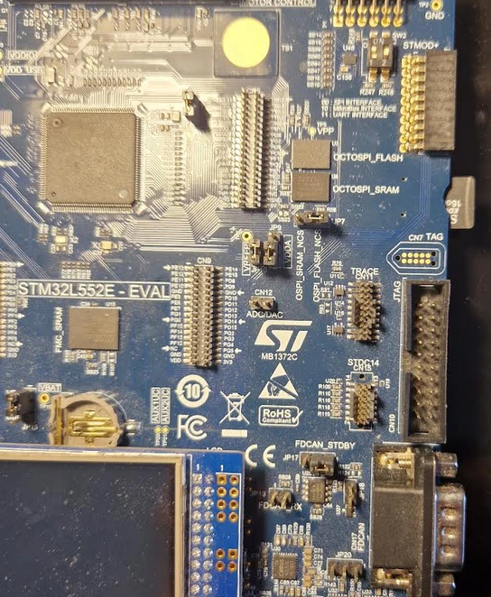

I have a evaluation board STM32L552E-EVAL and I would like the know how to connect the JLINK (EDU) to this board ? According to the instructions I see this connector which could possibly connect with the JLINK

For the 2 connectors it is compatible. Now how to compile a program and do DEBUG with JLINK ? To have a lot of the documentation or the link is very good but now how to work with the SEGGER ?

Yes, that would be the correct connector.

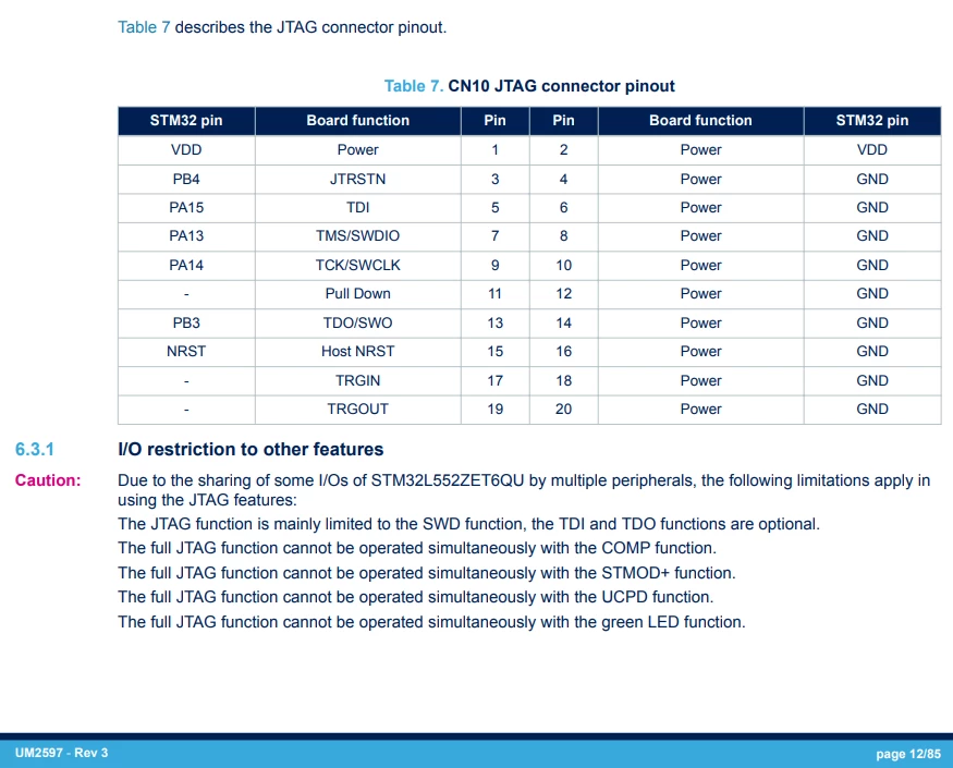

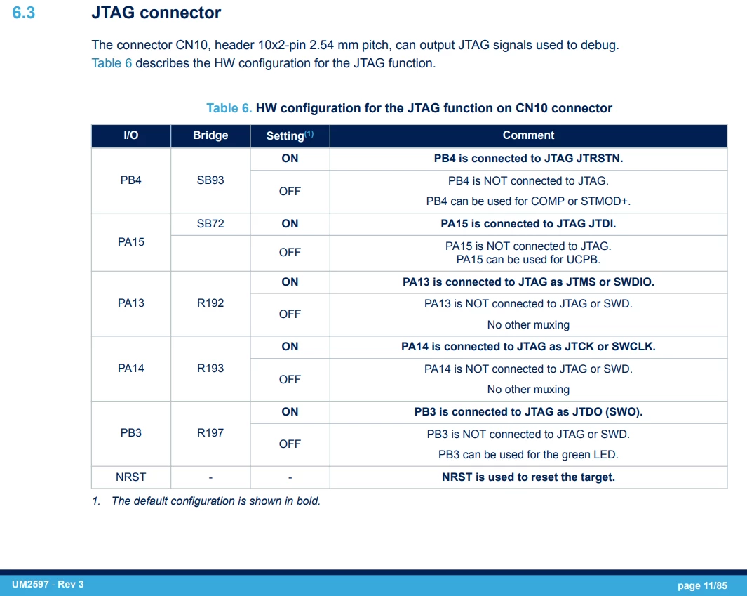

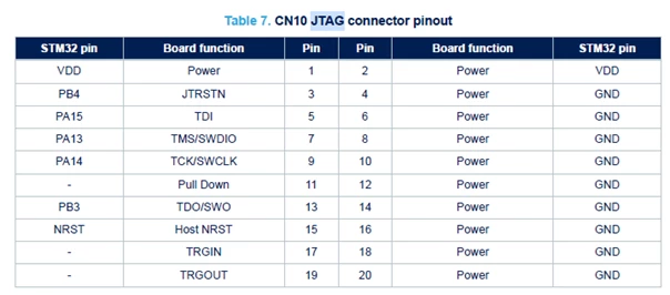

See also Tables 6 & 7 in the User Manual.
It matches the standard ARM pinout:
https://documentation-service.arm.com/static/5fce6c49e167456a35b36af1#page=3

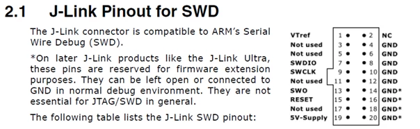

Your J-Link documentation will tell you the pinout of your J-Link - it should cover the standard ARM pinout...

I don't have the same board (Cortex Debug # CN7 TAG)
For the Tab 6 and 7 in the User Manual, I don't know what you're talking about I have this one  :
Are you sure it's an STM32L552E-EVAL card ?
Yes:
https://www.st.com/resource/en/user_manual/um2597-evaluation-board-with-stm32l552ze-mcu-stmicroelectronics.pdf
Note that the picture I posted in my previous post is from an ARM document - not ST - illustrating the ARM standard pinout.
