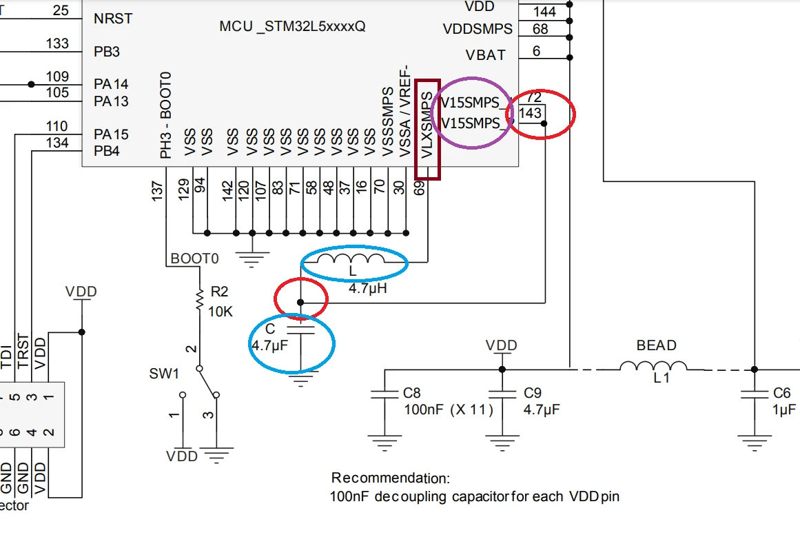

STM32L552 SMPS hardware design

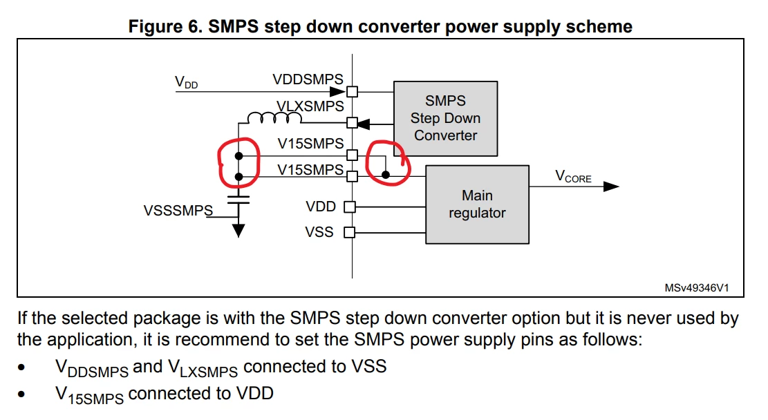

I have a question about connecting of the SMPS V15SMPS pins. From the datasheet we see, that the V15SMPS_1 and V15SMPS_2 pins are connected internaly. But, on the "Figure 6. SMPS step down converter power supply scheme" they are alco connected externally.
So, the question is: should I externally connect V15SMPS_1 and V15SMPS_2 pins on my PCB or not.

Hello
One of the reasons that power pins are multiple is to well distribute flowing currents on silicon chip.
IMO both pins must be connected.

Hi Dmytro Medvid,
V15SMPS_1 and V15SMPS_2 pins are already connected internally in the chip.
For the PCB, you should connect these pins externally.
Please refer to the AN5211 for more details (p33/40).
