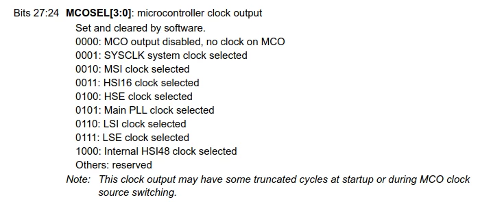

Hi, I am trying to program a STM32L552ZEQ to use HSE instead of the default clock, but I am doing something wrong.
I attach the reference manual, as well as the user manual for my specific board. In the user manual, on page 24, it is stated that there is a HSE with 16 MHz clock frequency. I try to enable this by setting the HSEBYP and HSEON bits in `RCC->CR`, like so
RCC->CR |= RCC_CR_HSEBYP_Msk | RCC_CR_HSEON_Msk;
while(!(RCC->CR & RCC_CR_HSERDY_Msk));
Using GDB I observe the change to the register value happening as expected. After setting it, I am waiting for the hardware to set the HSERDY bit, indicating that everything went OK. But this bit is never set. I never seem to get out of this while-loop. I observe the bit not being set using e.g. GDB.

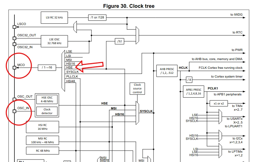

I looked at the reference manual and saw that MCO is fed to OSC_IN, which seems correct.

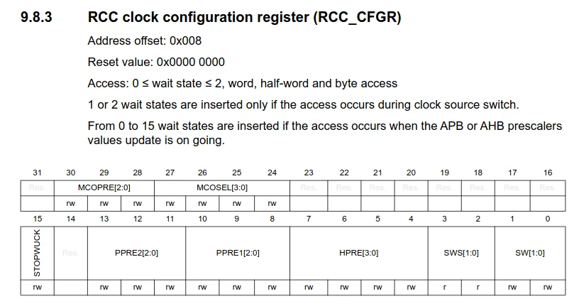

I then thought that it appears as if the MCO can be connected to several different sources, one of which being the HSE. I look at the reference manual, and find this
Screenshot from 2024-10-10 16-02-41.pngScreenshot from 2024-10-10 16-02-28.png
I modify my code to configure MCOSEL to have the value `0100`, to indicate that we should output the HSE to the MCO pin. I am using the CMSIS header files to access the correct addresses, and it seems as if the define for MCOSEL_2 carries the right value (4).
// the define is in the CMSIS header-file, but I paste it here for clarity
#define RCC_CFGR_MCOSEL_2 (0x4UL << RCC_CFGR_MCOSEL_Pos) /*!< 0x04000000 */
RCC->CFGR |= RCC_CFGR_MCOSEL_2;
This seems to make no difference at all, and I am now a bit unsure of how to progress.
Thanks in advance for any tips that might make me able to figure this out.

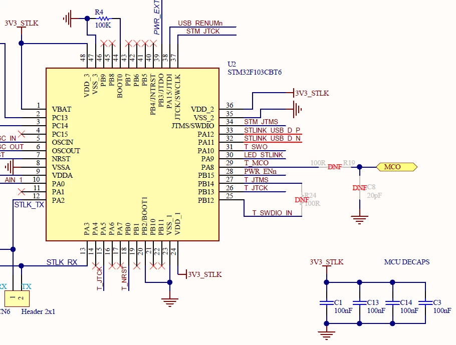

Oct 11, 2024 3:45 PM UTC
It looks like you have done the correct things with the hardware and software.
I wonder about R19 on the ST-LINK:
It looks like that would need to be present.

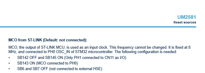

Andrew Neil
Oct 10, 2024 2:21 PM UTC

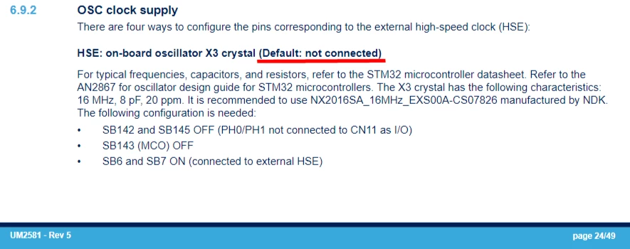

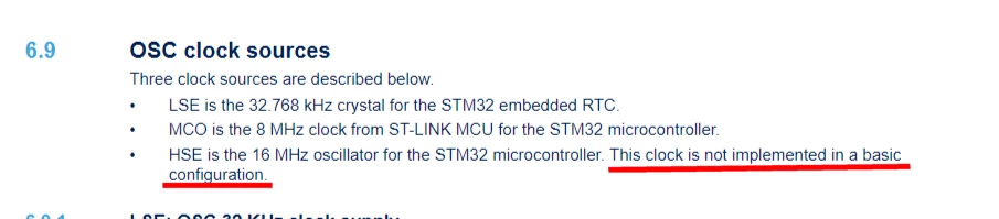

@krook wrote:
In the user manual, on page 24, it is stated that there is a HSE with 16 MHz clock frequency. .
It also states that, by default, this is not implemented:
So have you made the necessary hardware changes?
krookAuthor
Oct 10, 2024 2:25 PM UTC
I am not sure that I have. I've ever made modifications like this, where can I read more about that? I thought I could implement it in software.
Chris21
Oct 10, 2024 3:01 PM UTC
I would connect the solder bridges to use the 8 MHz MCO from the ST-LINK.
Andrew Neil
Oct 10, 2024 3:11 PM UTC
I think the default hardware configuration should be that the solder bridges are set for the 8MHz MCO from the ST-Link?
Correction: UM says it isn't (credit @Chris21 )

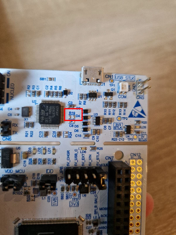

krookAuthor
Oct 12, 2024 2:07 PM UTC
@Chris21, that does indeed seem relevant. May I ask where you found this diagram? For my own future reference in trying to figure these things out.
When I look at my board, there is indeed what I interpret as an OFF solder bridge there. I believe that I should put another 0-Ohm resistor there to make the current be able to pass. This was less obvious to me as R19 was not mentioned in the two documents I looked in. It makes sense that this detail should be found in the ST-LINK documentation, but I only considered that my STM-board was misconfigured.

I was going to add a question, what does 100R mean? It is stated next to R19 in the diagram @Chris21
Chris21
Oct 14, 2024 2:38 PM UTC
The schematic for the board is on ST's web site: https://www.st.com/en/evaluation-tools/nucleo-l552ze-q.html, click on the CAD resources tab.
100R denotes a 100 ohm resistor, but 0 ohms (or a bit of solder) should work.
Did you check with an oscilloscope to see if there's a clock signal at SB143?

mƎALLEm
Oct 17, 2024 2:40 PM UTC
Hello @krook ,
Just to remind you that even with STLINK-V3 (the version on STM32L552ZEQ Nucleo board), the MCO is configurable and the default config is generated from HSI (HSI/2 = 8MHz) not the HSE crystal of the STLINK.
So if you are looking for an accurate clock source, you need to configure your STLINK. Please read this article.
