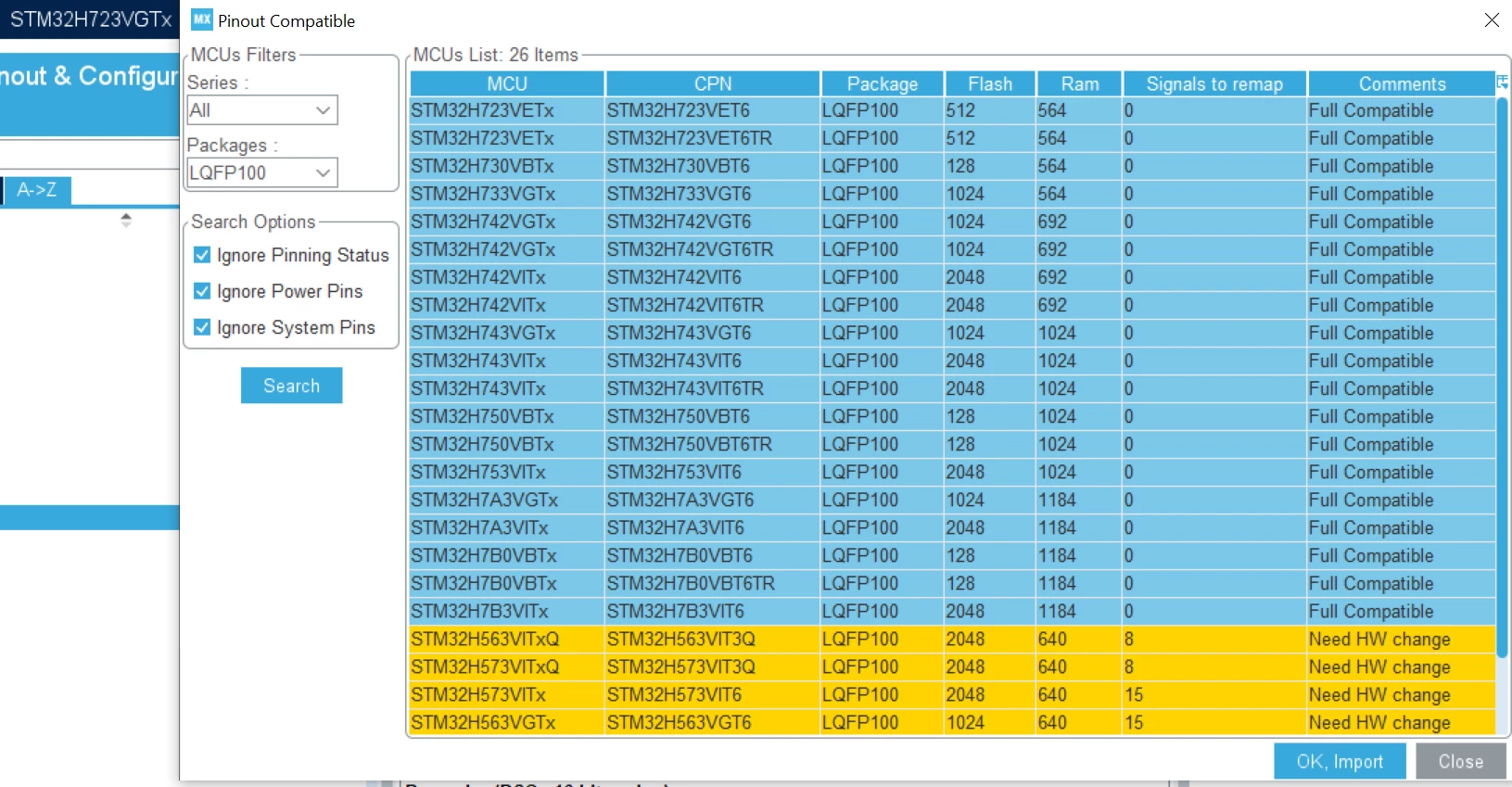

Is the STM32L4P5G-DK Discovery Kit also compatible with other STM32L4P5xx components, not just the STM32L4P5AG?

Hello @Sarvesh_2 and welcome to the ST Community :smiling_face_with_smiling_eyes:.
The STM32L4P5G-DK is a discovery Board based on the STM32L4P5AGI6P. If you are looking for MCUs pin to pin compatible with the STM32L4P5AGI6P. You can use the pinout compatible option on the STM32CUBEMX:(the picture is not for the L4 bit just an example)
Does this answer your questions.

Sarvesh_2Author
March 1, 2024
Hey STTwo-32,
That's perfect, thanks for the help!
