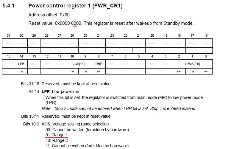

February 6, 2024

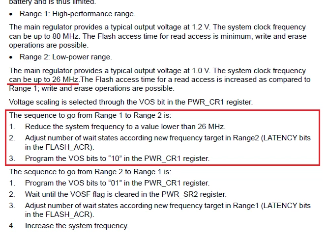

According to the RM, the dafault PWR config after reset is VOS1:
And there is a sequence to switch from VOS1 to VOS2:
Also what is your system frequency? You can't exceed 26MHz at VOS2!

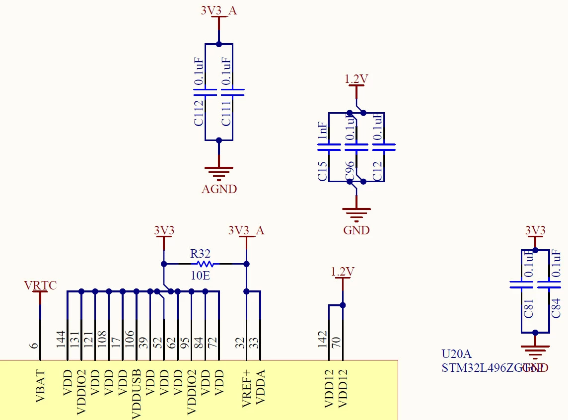

February 6, 2024

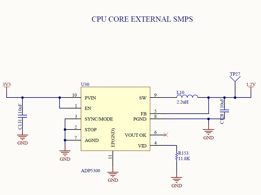

@AndrewFFFF wrote:
Some boards works fine (so.. i think there isn't a project problem)
That's not an entirely safe assumption: it could be that the design is marginal - so some boards just work, while others just fail ...
The PWR_REGULATOR_VOLTAGE_SCALE2 has a number of limitations - are you sure you are strictly within  them all?
https://www.st.com/resource/en/application_note/an4978-design-recommendations-for-stm32l4xxxx-with-external-smps-for-ultra-low-power-applications-with-high-performance-stmicroelectronics.pdf
February 6, 2024
Thank you for your fast answers:
I "inherited" this board and i didn't project this board, so i need time to replay your question.
Here in main.cpp:
#if USE_20_MHZ_CLOCK
	//For 20Mhz core clock freq
	RCC_ClkInitStruct.AHBCLKDivider = RCC_SYSCLK_DIV4;
	RCC_ClkInitStruct.APB1CLKDivider = RCC_HCLK_DIV4;
	RCC_ClkInitStruct.APB2CLKDivider = RCC_HCLK_DIV1;
#endif
#if USE_40_MHZ_CLOCK
	//For 40Mhz core clock freq
	RCC_ClkInitStruct.AHBCLKDivider = RCC_SYSCLK_DIV2;
	RCC_ClkInitStruct.APB1CLKDivider = RCC_HCLK_DIV8;
	RCC_ClkInitStruct.APB2CLKDivider = RCC_HCLK_DIV2;
#endif
I think 40_MHz for debug mode
About the hardware i share some photo about the power supply:

February 6, 2024
I've already said: you need to implement the sequence to switch from VOS1 to VOS2.
To me it's not a HW issue for the moment. You need to implement the sequence as described in the RM.
