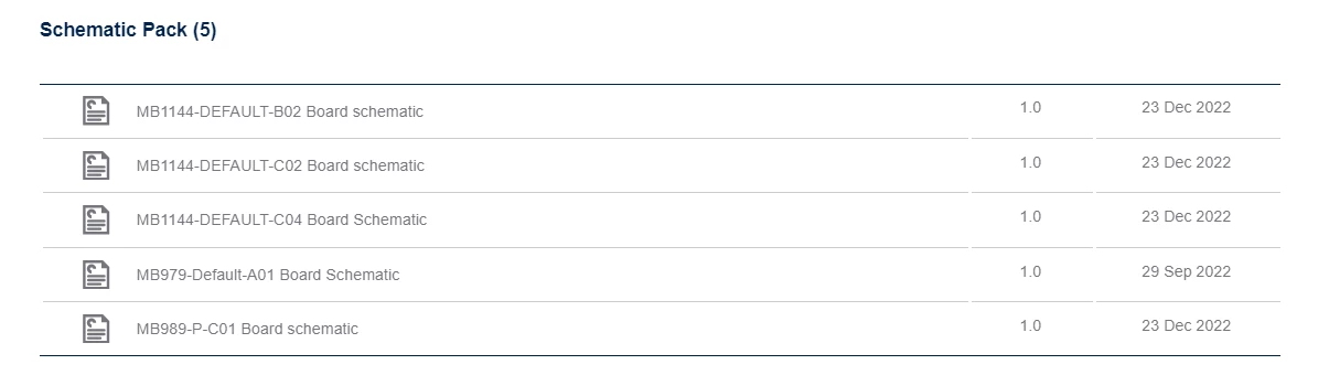

I have an STM32l476G evaluation board. I've configured the CubeMX project to enable the RTC to be run from the 32KHz LSE crystal which should be X1 on the board. However, when putting an oscilloscope on the x1 pins, I do not see any oscillation coming from the pins. I'm not sure if there's a jumper, or bridge I need to change on the board, as I can't find the schematic for the evaluation board online. PC14 and PC15 does not oscillate as well, which is expected as I can't see anything coming from the crystal.

Hello @JSC4 and welcome to the Community :),
You can find the Schematic board in the CAD Resources of STM32L476G-EVAL.

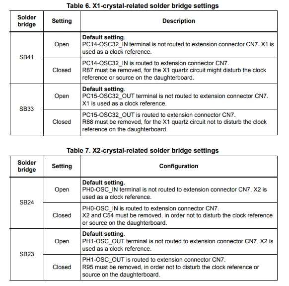

I advise to check the solder bridge, for that I recommend you the UM1855.
I hope this help you!

Thanks for pointing me to the CAD files. I still don't understand why it's not working. The solder bridge settings for X1 (SB41/SB33) are exactly like the X2 settings (SB24/SB23). By just powering the board, should both crystals be working, or does it have to do with firmware as well?
