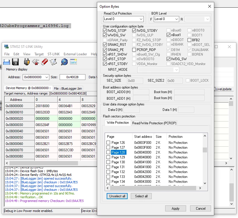

STM32L476 Error: failed to download Segment[0]
Hi
I'm using Atollic TrueSTUDIO® for STM32, Built on Eclipse Neon.1a. Version: 9.3.0 Build id: 20190212-0734
I get the following error when I try to debug:
Error: failed to download the File
Time elapsed during download operation: 00:00:08.714
Verifying ...
Download verified successfully
Encountered Error when opening C:\Program Files (x86)\Atollic\TrueSTUDIO for STM32 9.3.0\Servers\STM32CubeProgrammer\bin\STM32_Programmer_CLI.exe
Error in STM32CubeProgrammer
Debugger connection lost.
Shutting down...
everything was fine before I wrote a few extra functions that pushed from 127 sectors into 128 sectors.

STM32 ST-LINK Utility loaded the same bin file without error.
0693W00000NqtXBQAZ.pngThe STM32L476 should have 1MB flash, and I've used just over1/4 of it.
I was using no optimization (-O0) when the error occurs. And I have confirmed that with the same code, if I optimize for size (-Os) then the error goes away.
Eventually, my code size will grow and hit this error again.
Please help me get over this limit.
Cheers
Harry

Hello @HLi.1047​ ,
Try to upgrade firmware version using STM32 ST-LINK Utility: go to ST-LINK>firmware update,
 Then disconnect and connect your board.
I also advise you to update the STM32Cubeprogrammer and use the latest release.
Keep us informed about your update.
Imen

Hi​ Imen
Thank you so much. Your instructions fixed it.
STM32 ST-LINK Utility showed that I had:
STM32+STM8 Debugger
V2.J37.S7
I reflashed my st-link V2 even though it was the newest firmware.
Then download the newest STM32CubeProgrammer 2.10, installed it, and followed the following instructions to integrate it into TrueStudio:
https://www.st.com/resource/en/application_note/an1801_stm32cubeprogrammer_in_truestudio-installing-stm32cubeprogrammer-in-truestudio-stmicroelectronics.pdf
I had:
STM32CubeProgrammer v1.3.0
Which is very old, I assume it came with TrueStudio, because I never integrated into TrueStudio.
Then everything just worked without optimization.
