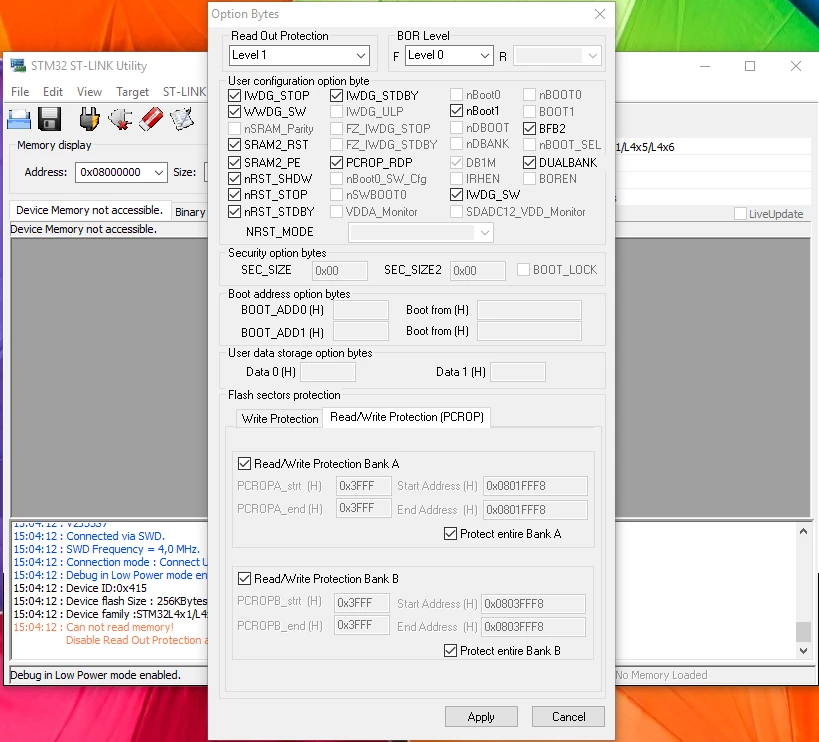

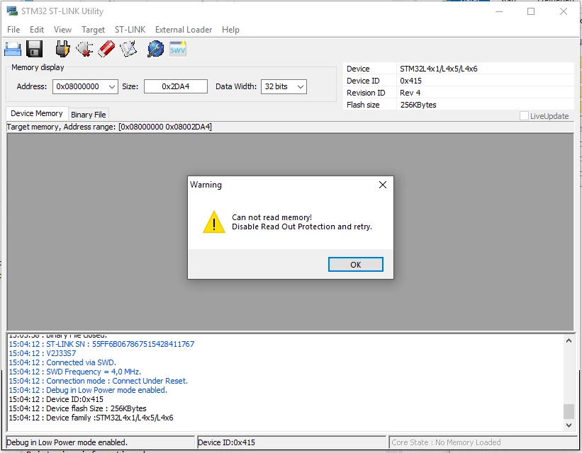

Hey,
I try to implement an update mechanism by using the dual-bank boot mechanism of the STM32L475RC. In general the bank swapping works, but sometimes, when I remove the power supply in the wrong moment during the OptionByte-Launching, the microcontroller doesn't boot anymore.
When I try to connect to the STM32 via the STM32 ST-Link Utility, it seems that the read-out protection was enabled (see pictures).
Option Bytes:0690X0000088a4qQAA.png
This is the code to set/reset (and launch) the BFB2-OptionByte Flag in dependency of the selected bank:
