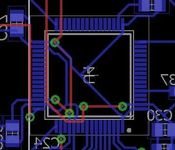

0693W000001cLwVQAU.jpgHello,
I'm doing the layout of a PCB with a STM32L433RCT6 . On the datasheet seems that this micro doesn't have a thermal pad. Also in the libraries I downloaded from Mouser , there is no thermal pad. I'm new with this family of microcontroller so my question is does the micro have the thermal pad ? Can I place vias under it (see picture).
Thank you
Riccardo

Uwe Bonnes
Chief
May 15, 2020
No. there is np thermal pad.
RStra
RStraAuthor
May 15, 2020
thanks for your response. What does it mean "np thermal pad " ?
Thank you
Riccardo
andy2399
Senior
May 15, 2020
Its a typo he is confirming that there is NO thermal pad on this device.
Andy
RStra
RStraAuthor
May 15, 2020
So I can put all the vias I need. Thanks
