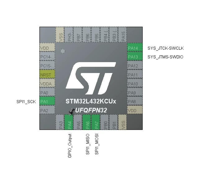

My .ioc pinout view looks like this:
0693W00000QN0RvQAL.pngNote: In video, the SPI1_SCK has been automatically given to PA5, but for my board it was shown as PA1, hence have made the connections accordingly.

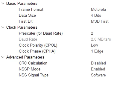

SPI1 enabled:
  1. Mode - Full Duplex - Master

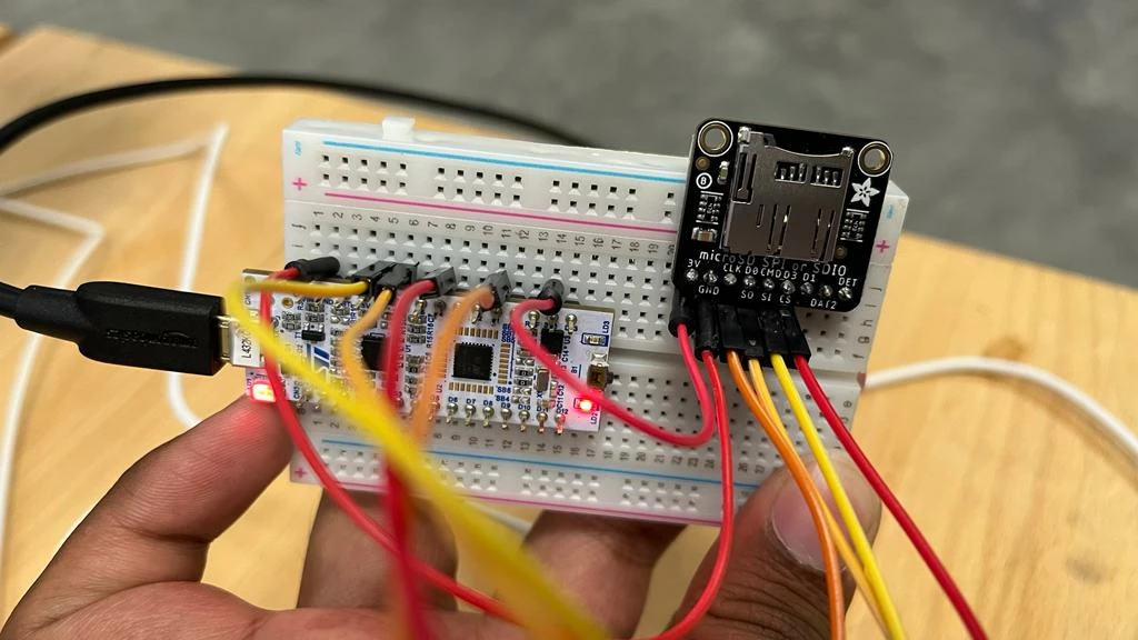

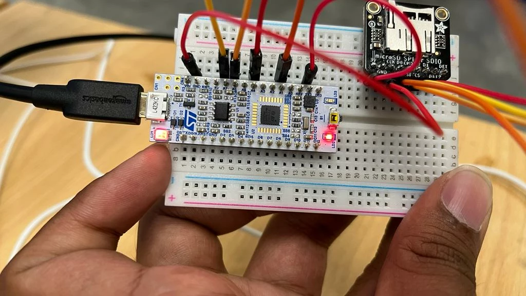

After following the video, My build is complete with no errors. Then I make the hardware connections for my board like this:

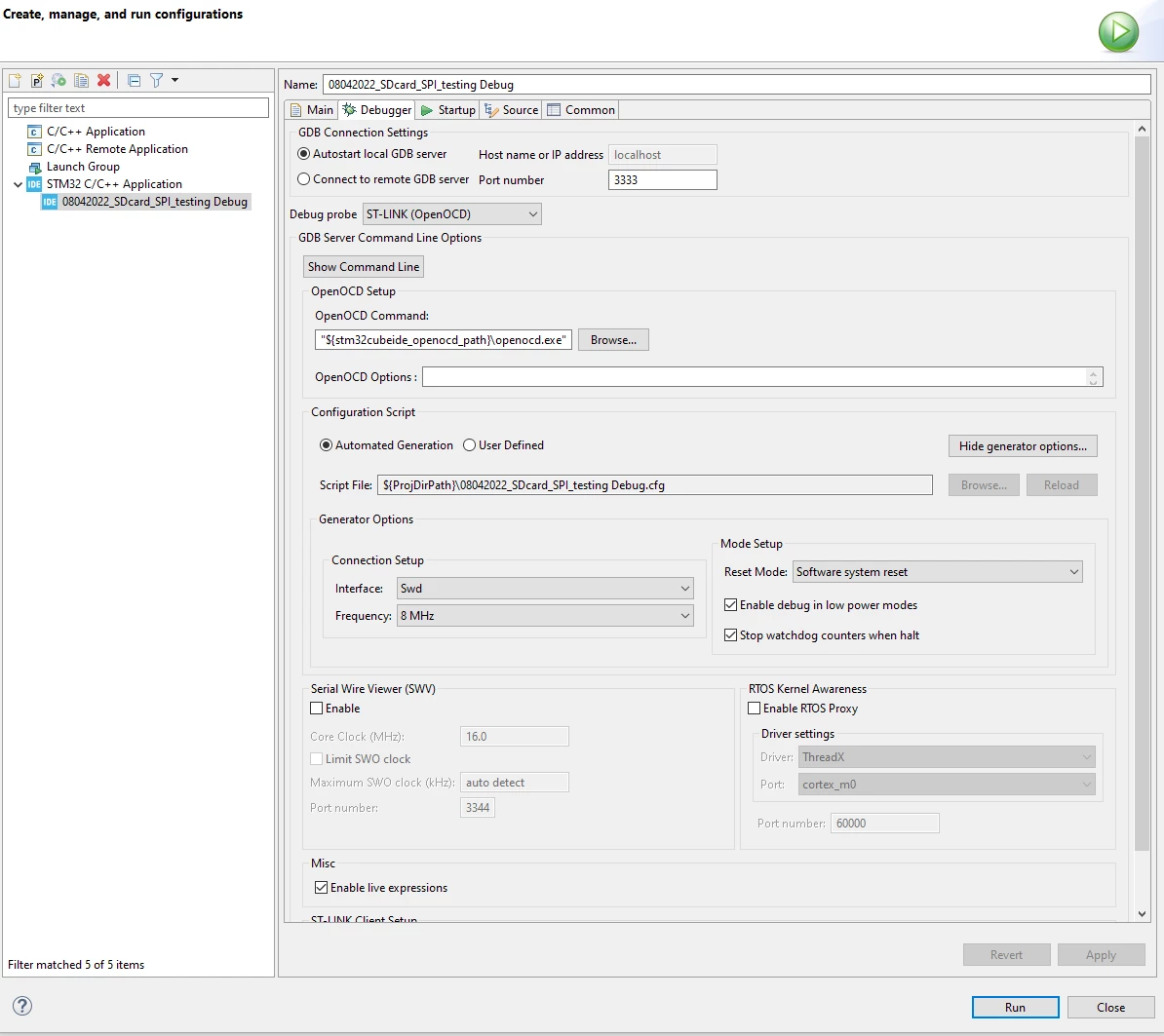

When I am running the file to download the code to board, I am changing the run config file as shown in the video: changing the debug probe to OpenOCD (I don't know much about what this does) and changing the Reset mode to Software System Reset.
So when I click on Run, I get the following error:

When I run using the default setting in Run Config; which is debug probe set to ST-LINK (ST-LINK GDB server), I get no errors while downloading to board, but I don't see any file written on to the SD card. Attaching the console log of the same below:
