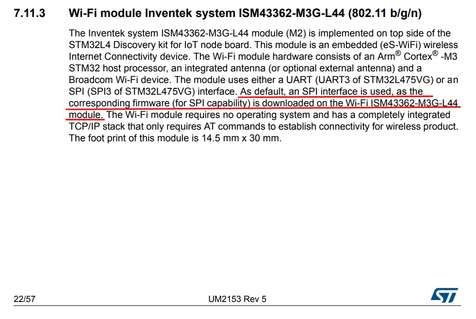

It's not entirely clear, but the board's User Manual suggests that the WiFi module firmware may be SPI-specific:
Again, Inventek and/or the module documentation should clarify that...

Mike_ST
Mike_STBest answer
Mar 19, 2025 1:20 PM UTC
you can't use the USART3, as it would require another version of the Wifi module. USART is inactive on that one.
For the background story, both the USART and SPI lines are connected to the module because at the time of the design, we just had the pinout of the Wifi module and did not know what interface would be useful in the end.
+ the unuseful USART lines have never been removed in the latest revisions of the PCB.
>> The problem is that currently both are using SPI3 and both need different bits and prescalers to work properly.
Same answer as above, hw design team didn't know about such details.
You have to switch between the SPI settings depending of which module you are talking to.
