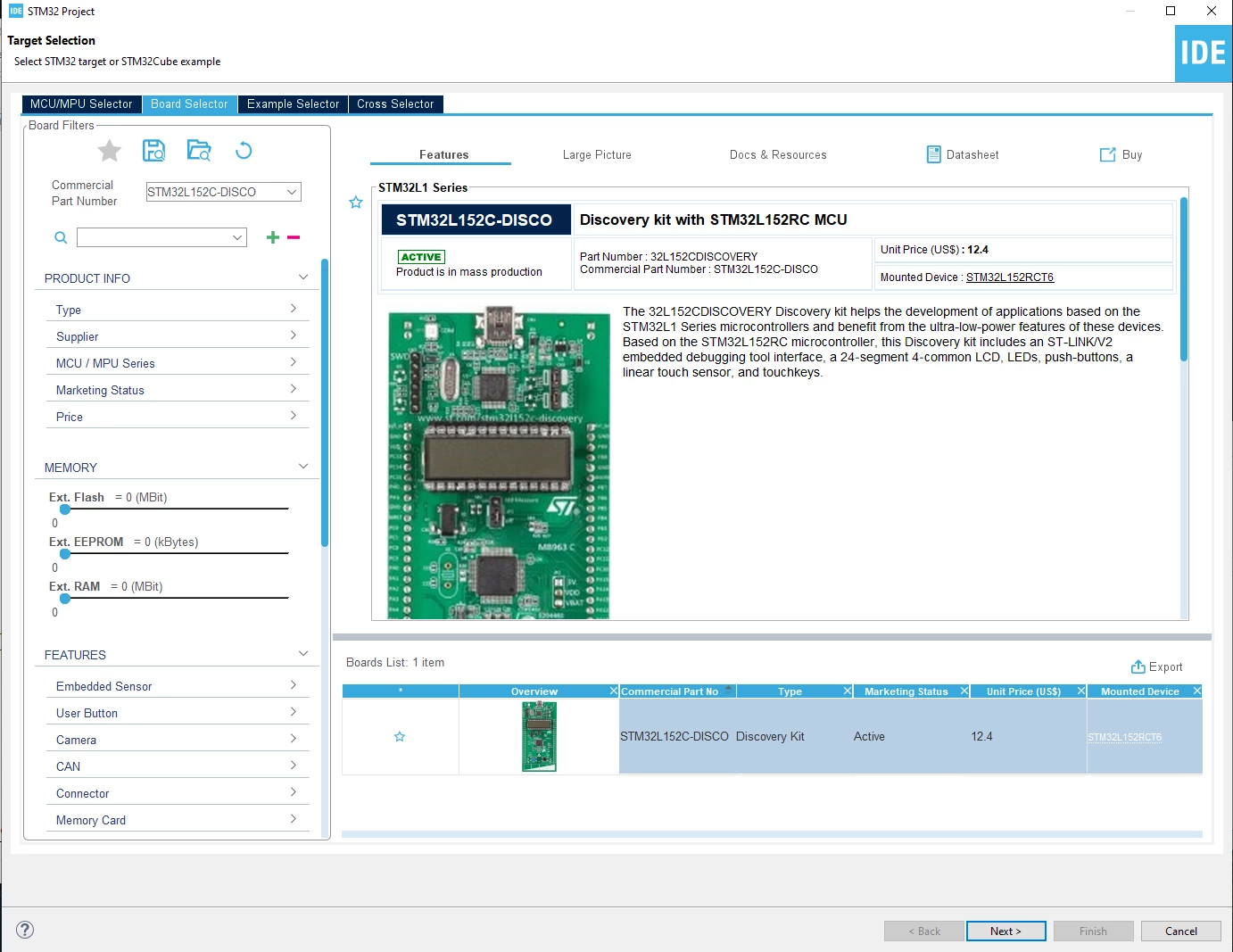

I create empty STM32project using Board Selector option:

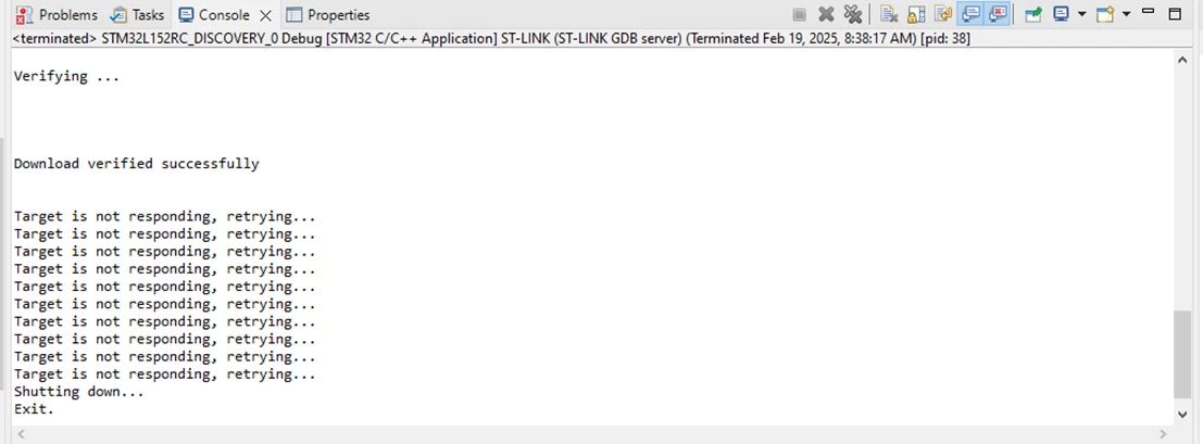

I made a simple program to make the LEDs on the board blink, but it cannot be debugged.
The program downloads correctly, but this message appears:
The board appears to be resetting, because the LEDs are blinking very fast, as if the program were continually restarting.

Your observed problem has nothing to do with the STM32CubeIDE, but with the usage of the board. Please bear in mind that it is not a NUCLEO board, but a DISCOVERY, where existing functions must be taken into account. In this specific case, when single stepping through the program, you will notice that you see the same messages in routine MX_GPIO_Init(void)when initialising pin IDD_CNT_EN_Pin, which is due to the enabling of counter U3 (M74HC4060, see schematics).
If you change the jumper J1 (Idd Measure, under the display) from ON to OFF and thus disable the counter, your programme should work without any problems - right?

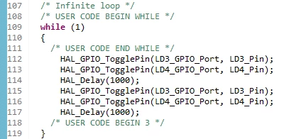

The information I've provided contains enough information to start working on the solution. And I'm providing the code I've used, which is only 6 lines that I've added to the program that, by default, creates the cubeIDE configurator.

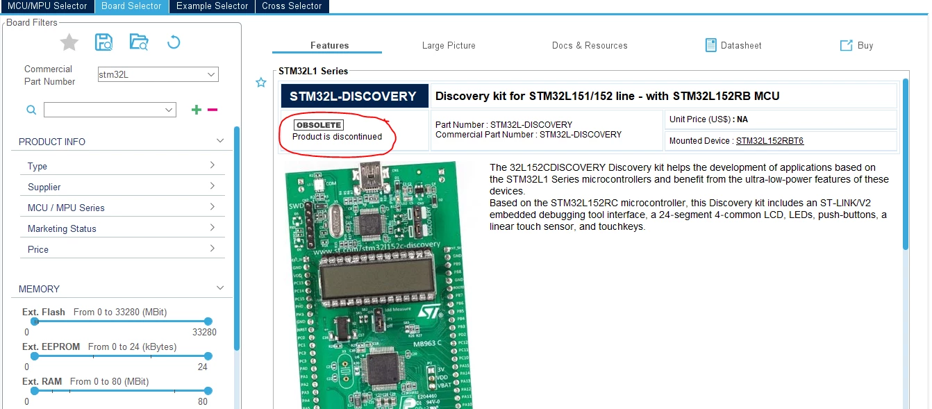

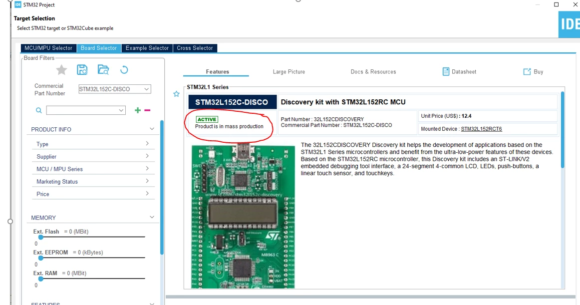

The development board I'm using is not obsolete:
Maybe you're referring to this other board, same appearance, but with a different microcontroller:
The library I mentioned is for the old board, and the old ST IDE, called SW4STM32. That's why I'm asking for examples or test programs for the new board, that work with the new ST IDE, CubeIDE.
