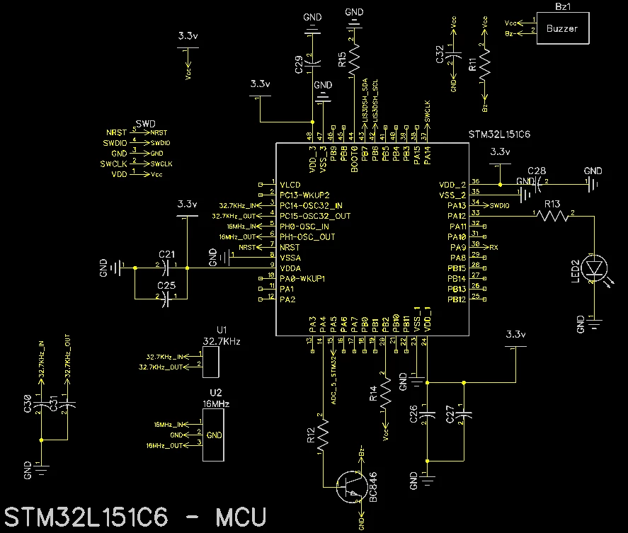

I'm facing an issue while trying to program STM32L151C6 using STM32F4 Discovery board as programmer. What I did are the following:
1. I removed CN3 jumpers from STM32F4 Discovery board page 14 in [
https://www.google.com.sa/url?sa=t&rct=j&q=&esrc=s&source=web&cd=1&cad=rja&uact=8&ved=0CB4QFjAA&url=http://www.st.com/st-web-ui/static/active/en/resource/technical/document/user_manual/DM00039084.pdf&ei=f58IVcOiNcb4Uo7vgNAD&usg=AFQjCNE7wWFkc36n9LqACgAqzuc_c-tdGw
][1]
2. I connect NRST, SWDIO, GND, SWCLK, Vdd to my target STM32L151C6 SWD pins except SWO ( I kept it floating)
Pin:number CN2 (STM32L151C6) Pin:1 Vdd Pin:2 SWCLK (PA14) Pin:3 GND Pin:4 SWDIO (PA13) Pin:5 NRST (NRST) Pin:6 SWO (No Contact)
3. I used STM32 ST-Link Utility V2.2.6 to test SWD.
The result is ''Cannot connect to ST-Link''
I've attached the schematic for my circuit design.
I really appreciate your prompt help guys to facilitate this issue.

I'm not sure if that error means it can't see the ST-LINK, or the chip attached to it. If you go back to the F4 settings, does that work immediately.
Is the VDD connection necessary, or is it powering your board?
Is the part correctly orientated?

Hello alharthi.waleed,
I'm using the ST-Link/V2 myself on a custom PCB and it works fine.
Your SWD setup looks correct except for one part that makes me suspicious:
VDD->Vcc
The SWD interface does not provide means to power the MCU, but it does take the MCU VDD as an input.
You need to provide a power supply for the MCU from elsewhere (as you wrote, you use a battery).
Not sure what Vcc voltage is since you run it over a resistor, but the SWD VDD should be connected directly to the MCU VDD (3V3).

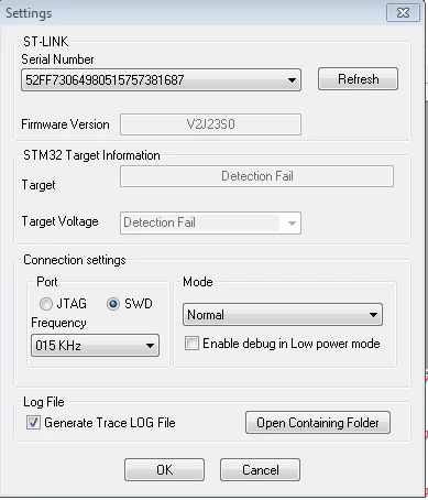

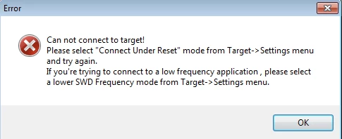

Posted on March 18, 2015 at 15:07
Hi Daniel,
I've checked the power and it's fine there is no drop in voltages however once I tried to connect with STM32 ST-LINK Utility with the below configurations:
I got below error message:
