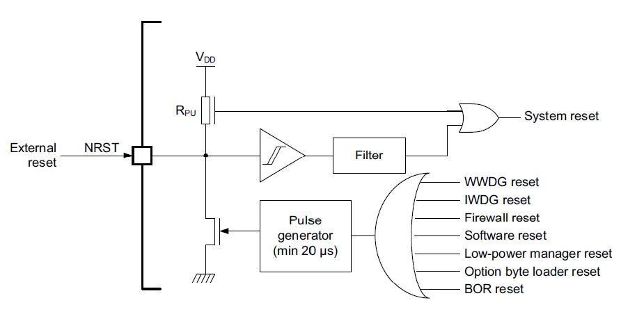

I understand the possible reasons for reset as per following image

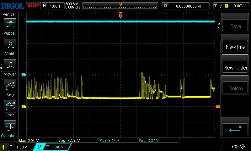

The voltage on reset pin is varying however the supply voltage is clean, you can refer the following image.0693W00000AN57NQAT.jpg

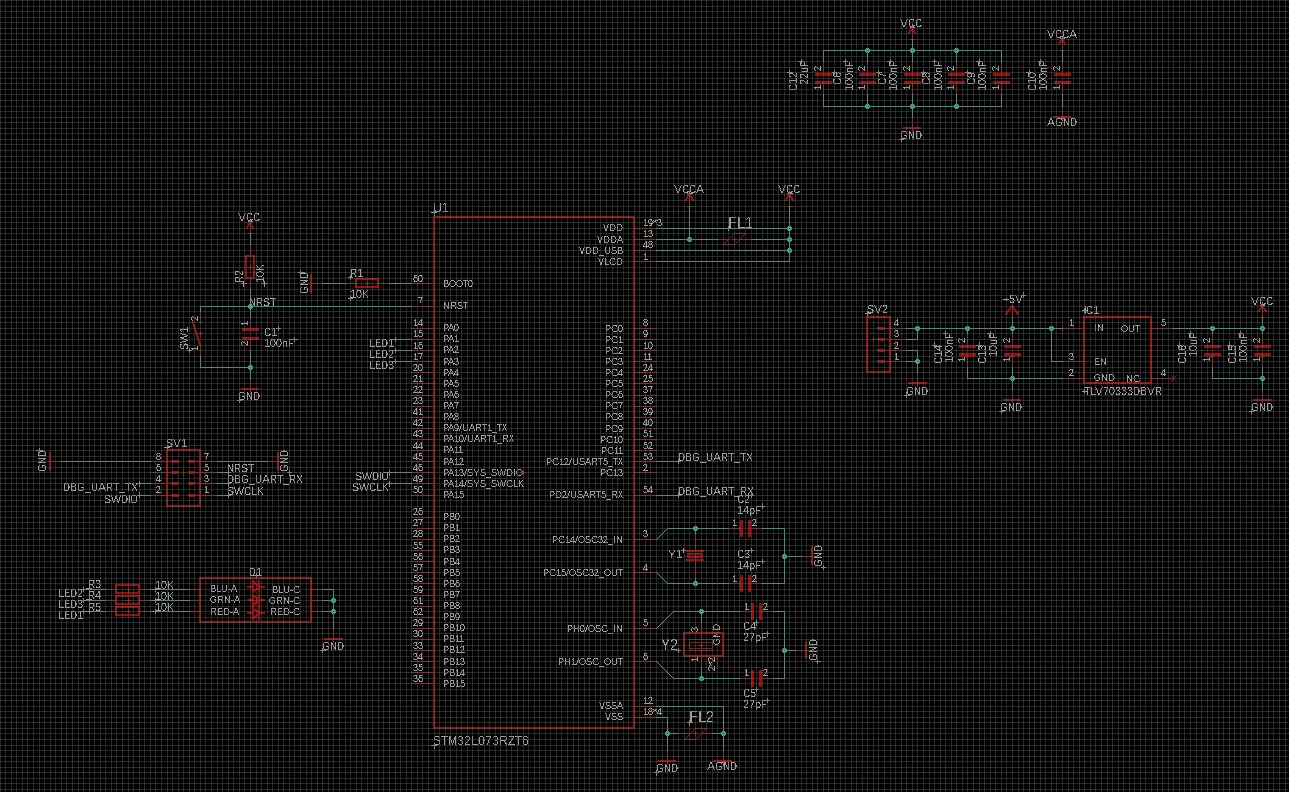

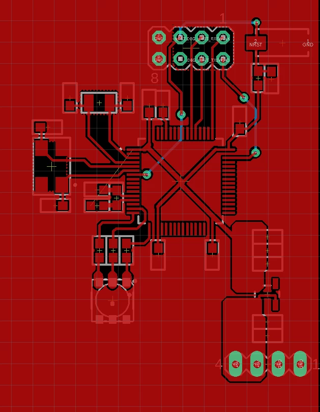

I have attached images of my schematic and layout for your reference, in attached layout you will observer AVCC pin is not connected anywhere I put a jumper there as it is a single sided PCB. please let me know how can I resolve this issue.
