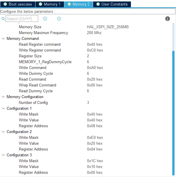

I am trying to run some basic tests on the STM32H7S78-DK discovery board.
I am having some trouble properly initializing the PSRAM (is this info available somewhere, what are the right settings?)
PSRAM is clocked at 200MHz, i copied settings from the available examples/bsp
I am having random errors, it looks like that sometimes the write is not executed
Most of the time like 99.99% of the case, everything works fine, but sometimes i read old data from the PSRAM, this mostly happens with 16 or 8 bit r/w but rarely also with 32 bit r/w
I have a test that writes the whole ram with some pattern then verifies it.
This happens in all combination of cache settings, but cache settings have a significant impact on the frequency of these errors (not clear why).
i'm logging the result, it looks something like this:

For the last T16 test, i.e. overwrite the whole PSRAM content with 0x0e28, using 16bit access, there are 8 differences at 8 consecutive memory locations, where the write silently failed and the old data from the previous test is still present.
Any ideas or suggestions on how to debug this? I can not physically check/measure the lines between mcu and psram as they are not accessible, neither i have the equipment for it.

Struggling on PSRAM random errors, I found on APS256 datasheet default setting at 5 latency cycles (read/write) corresponding to 133MHz max.
I have modified EXTMEM_MANAGER config as
to set 7 latency cycles (200MHz max) and now deep-testing...
