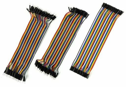

I admit that I feel like I'm missing something obvious here, but I am using the STM32H7B3I-EVAL evaluation board and they have 0.05" pitch header pins for some of their connectors (CN5/CN6). I am trying to source a single position connector that can connect to their header pins (P/N: FTR-130-53-L-D-LC).

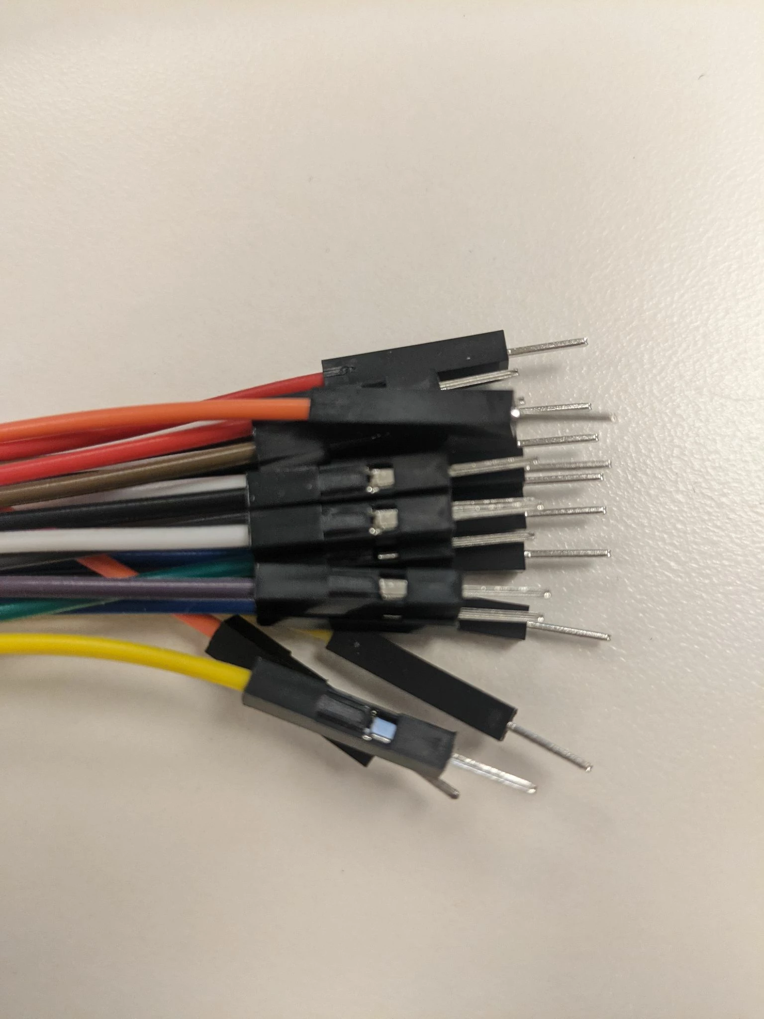

I am looking for something similar to the image below, but 1.27mm (or 0.05") pitch and female.
I want single-position so I can send various GPIO signals to different boards. Is anyone aware of a product that can do this?

For anyone else who has encountered this issue, I found a solution via Digikey.
https://www.digikey.ca/en/products/detail/chip-quik-inc/dr127d254p10f/5978230
I plugged the female portion into the header pins on the evaluation board and then just used regular 2.54mm connector pins for the other side. Each pin is its own trace, so it doesn't interfere with each other.
It's by no means an elegant solution, but if you're in a pinch, it works!

Sure, there are a lot of them in the internet shops with male-female combinations, e.g. like this one:
0693W00000WHcsDQAT.jpgDoes it help?

Hello Peter,
Yes, something like this would work perfectly, I just need it to match the pitch of that connector (0.05" pitch). I've found 100's of ones like the picture you provided, but they're all 0.1" (or 2.54mm) pitch. Can you link a specific one by chance?

Oh, that's right, I hadn't read correctly and assumed 0.1", sorry.
No, I haven't seen such plugs in 0.05" yet, but maybe someone else in the community?
