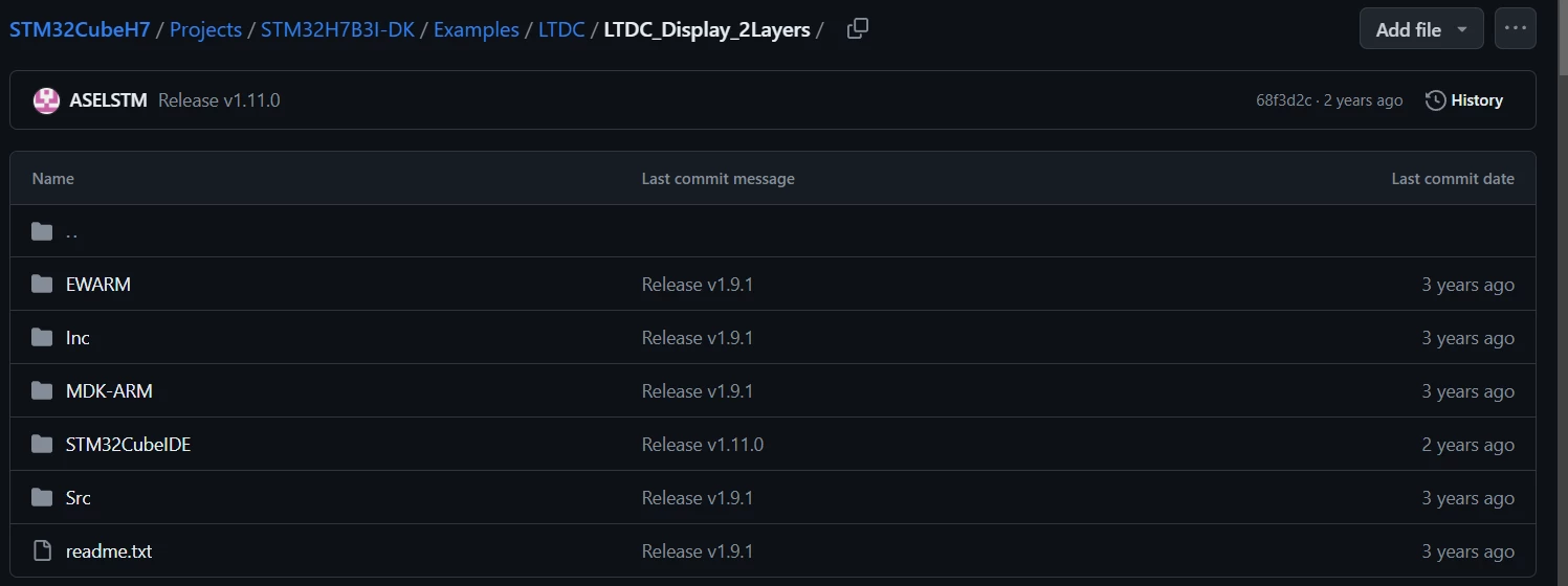

You may refer to an example for this board:
STM32CubeH7/Projects/STM32H7B3I-DK/Examples/LTDC at master · STMicroelectronics/STM32CubeH7 · GitHub
after the example is OK for your board, you may translate the source code to your desired style - only setting bits in the register.

Maybe a *** question but repo does not have the classic "Code<>" button where I can just copy the URL. Is there any other way to download the code?

February 28, 2024
You need to download the all package from this link
Then go to this path: \Projects\STM32H7B3I-DK\Examples\LTDC

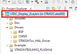

February 28, 2024
How you did open the project?
This is what you have to get as view:
You need to have "IDE" label in blue square on the project view.

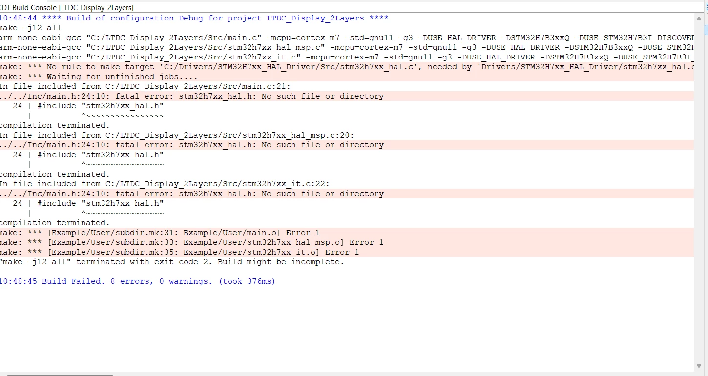

richiAuthor
February 28, 2024
I did manage to load it into workspace, but when I tried to build I get this error , in which folder should I paste that header file?
mƎALLEm
February 29, 2024
Sorry I didn't understand what you copied? and why you copied it?
You need to have the all package and build the project (out of the box) from here: STM32Cube_FW_H7_VX.Y.0\Projects\STM32H7B3I-DK\Examples\LTDC\LTDC_Display_2Layers\STM32CubeIDE\
 No need to copy or move any file!

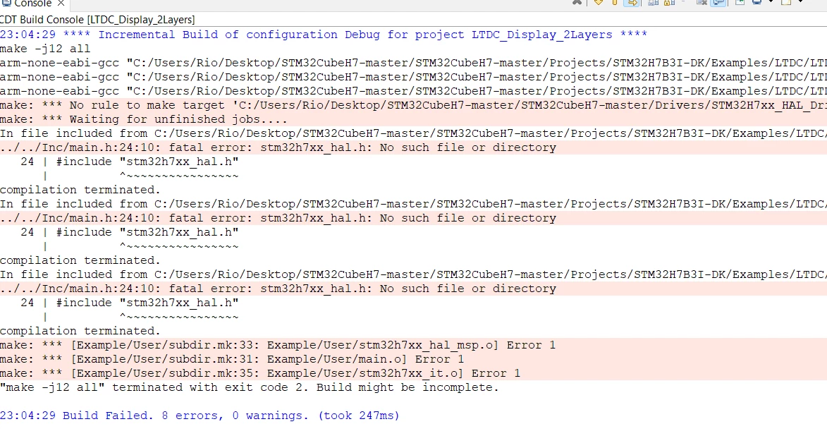

mƎALLEm
March 1, 2024
Please re-download the package from here and build the project as it is .. There is no problems with the projects.
Also try to shorten the path to the projects from your drive root for example copy your STM32CubeH7 package directly under C: as Windows uses a path length limitation.

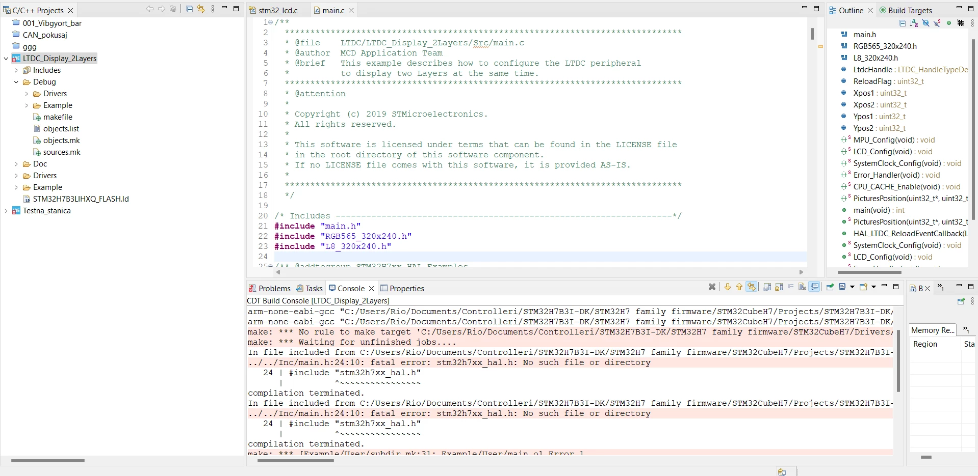

Peter BENSCH
March 1, 2024
@richi The firmware library uses relative paths and expects .c/.h files to be located at a specific relative position. So you cannot simply copy an example from the firmware structure and expect everything to be compilable.
Have you tested the examples directly from the directory structure recommended by @mƎALLEm , i.e. without copying them anywhere?
richiAuthor
March 1, 2024
I did , they out of the box cannot be built because they throw errors that stm32h7xx.h is missing

I can see from your screenshot that you are neither working in the unchanged directory structure nor using a short path as suggested by @mƎALLEm. As long as you do not implement this, you will always have problems.
richiAuthor
March 3, 2024
I must say that I dont understand what does it mean to "test the examples directly from the directory structure". I tried to go File >> Open Projects from File System choose the LTDC_2Layers directory , but then I am unable to build the project. If I go to LTDC_2Layers and click on the .project file it imports my project in Cube , I build it and the above picture is the result. I changed relative path in C: but error persists.
mƎALLEm
March 4, 2024
When CubeMx suggested you to download the H7 library did you do it?
You need to have the H7 cube package on this path <user>\STM32Cube\Repository\STM32Cube_FW_H7_VX.YY.ZZ
No need to import the project from File >> Open Projects . Simply open the project by clicking .project file.
