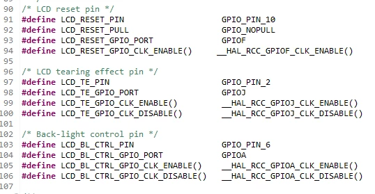

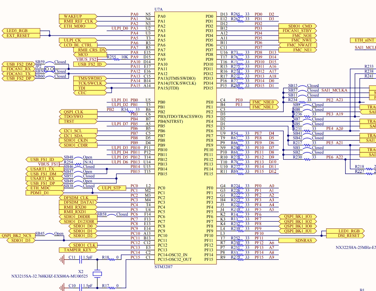

Which is correct:
BSP files assign PA6 as the LCD_RST line
Schematic assigns PA6 as the LCD_BL control line
BSP files assign PF10 as the LCD_BL line
Schematic assigns PF10 as the LCD_RST line
Which is correct?

Hello @Richard Lowe​,
For my side, I don't find any contradiction between the BSP file and the Schematic.
PA6 as LCD_BL_CLRL.
PF10 as LCD_RESET.
0693W00000Y7HAcQAN.png0693W00000Y7HBVQA3.pngCould you please share the STM32CubeH7 version are you using?
Thank you,
Kaouthar
