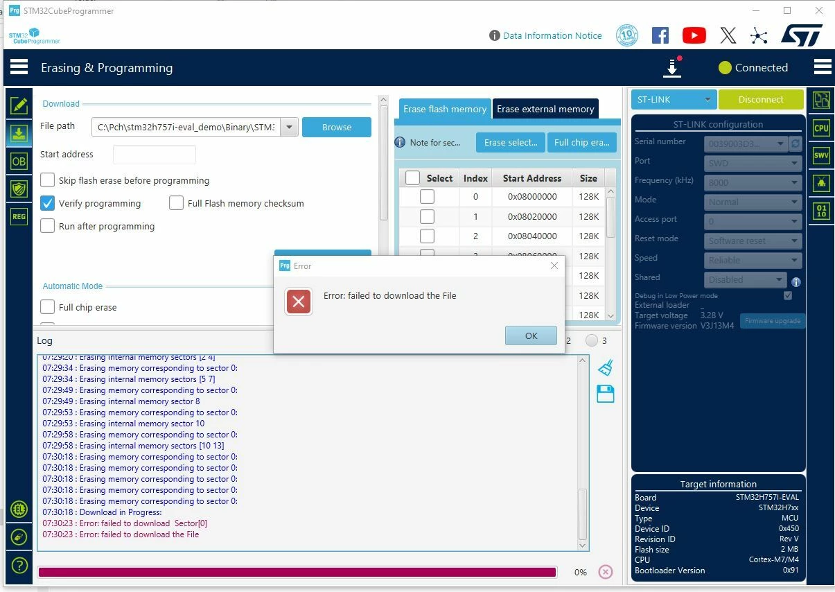

We recently bought a STM32H757I-Eval board and played around with it. This did overwrite the demo program it came with so I downloaded the stm32h757i-eval_demo.zip package to restore the demo.
I used STMCubeProgrammer for this, did a full chip erase and pointed it at the hex demo file. The programming failed with
                      Error : failed to download Sector[0]
I tried the other hex demo files in the with the same result and on two different laptops and the latest CubeProgrammer.
The weird thing is that when I power the board the demo seems to work as when new so I don’t know if only part of it is working. It could even have arrived in this condition.
Anyone else have this problem? and perhaps a fix?

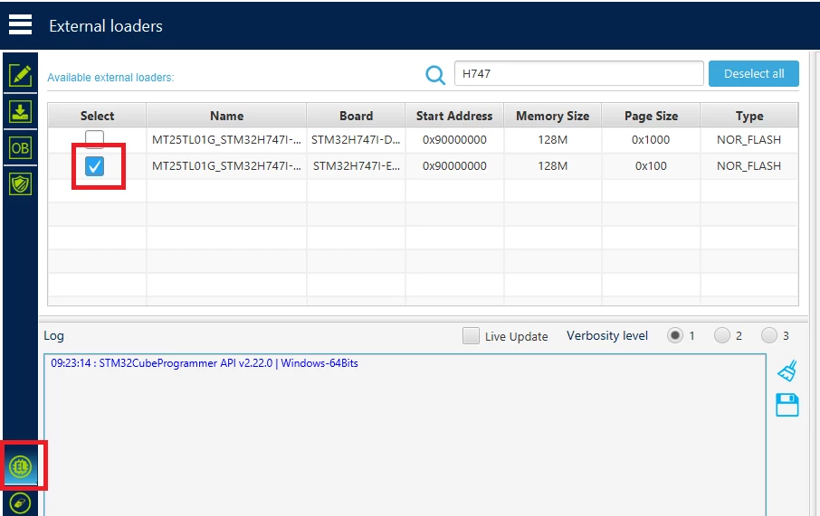

Did you select the external Flash loader of the external QSPI Flash memory before uploading the demo?

btrosUserAuthor
Jun 17, 2026 7:35 PM UTC
Thanks for that and the quick reply and no I didn’t use the external loader but now that I have it all works, thanks.
I overlooked the Howto section in the readme.txt, something to remember for the future.
