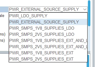

Jagan1Author
Nov 4, 2025 6:45 AM UTC
Hi, Thanks for the Solution. with this i am able to recover as by default configured as LDO, but again its going to same state. i am unable to find out the PWR_DIRECT_SMPS_SUPPLY i can see only LDO and External source in configuration. Please find the ioc file.
mƎALLEm
mƎALLEmBest answer
Nov 4, 2025 8:13 AM UTC
Because you set the system frequency > 400MHz:
Which is not available for SMPS config. Make the system frequency less than or equal to 400MHz, and PWR_DIRECT_SMPS_SUPPLY will appear in STM32CubeMx.
Please review the solution in this thread: Power brown-out on NUCLEO-H755 at max clock (480 MHz)??
Hope that helps.
