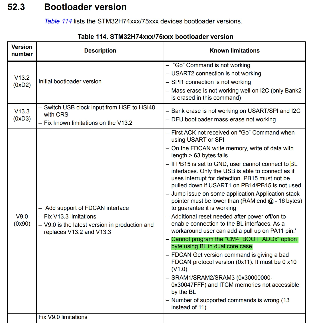

Hello @m.beddi,
You may need to check bootloader version. It is possible that you cannot program the "CM4_BOOT_ADDx" option
byte using BL in dual core case. Check *STM32 microcontroller system memory boot mode - Application note.
To give better visibility on the answered topics, please click on "Best answer" on the reply which solved your issue or answered your question.Best regards,FBL

thank you for your answer.
Do I need the CM4_BOOT_ADDx option when writing my own bootloader or is this only necessary for the ROM built-in bootloader?
My bootloader is supposed to fetch the data from SD card and write it to flash, I haven't figured out yet how the system bootloader can do that. Is that also possible?
Or do I still not quite understand something? My procedure would now be as described in my answer to ramprakash08. Will I have a problem with this procedure? Thank you.
