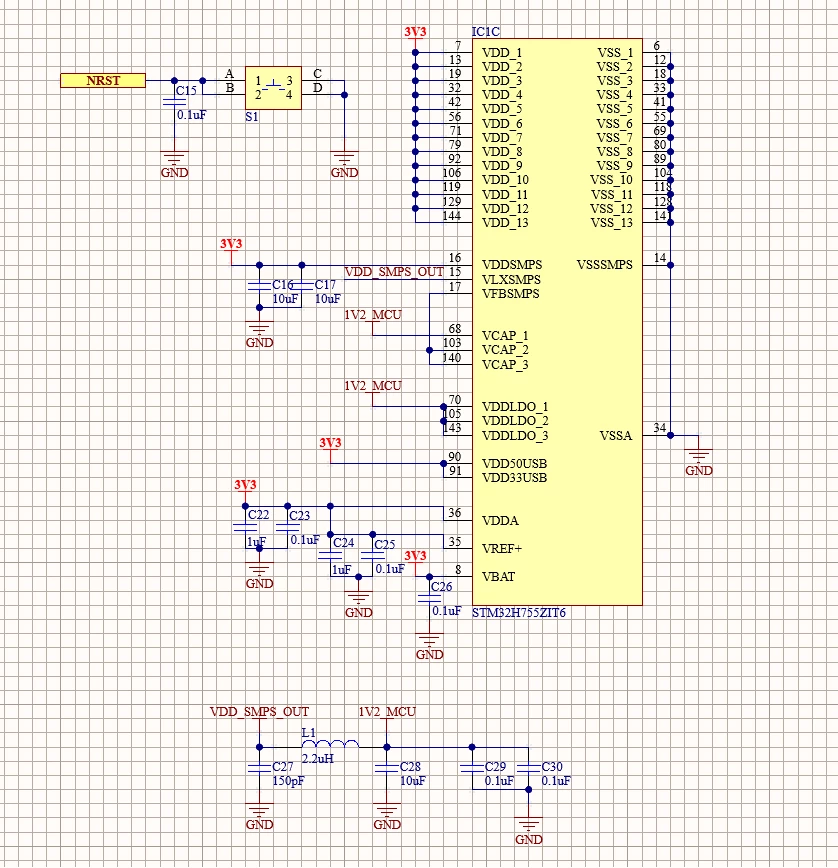

I am designing a board based on STM32h755zit6 MCU and it's the first time for me working on this MCU, I am trying to simplify the design as possible to avoid any problem in the development, since we are short in time.
I found out that there is a firmware configuration for the power, is there a default configuration so I can make the hardware based on it? right now I made this schematic based on the Nucleo board, but I want to make sure that it's right configuration, Also I have the ST-link 2 is it possible to use it for programming?
thanks

Again please review the AN4938 "Getting started with STM32H74xI/G and STM32H75xI/G MCU hardware" development:
And reference design schematics:

Hello @baselimadt and welcome to the community,
Better to remove the grid from the background in your schematics for more visibility.
Thanks.

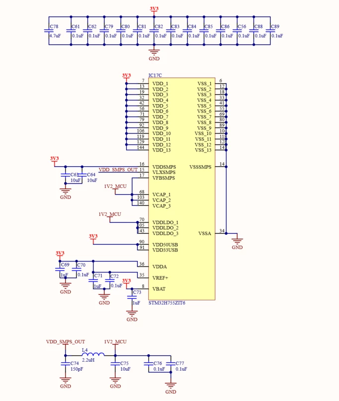

November 13, 2024
here is a picture without it

Shouldn't there be a pull-up resistor (typically 10 kΩ)  connected to the NRST pin?

No need for external pull-up resistor on NRST pin. There is one internal:

From hardware point of view:
1. STLINK V2 VS STLINK V3, the main point is speed.
2. I reminder you that pin17(VFBSMPS) is an input pin, not a power pin.
3. Normally, if it's a first design your side, to reserve some 0R would be better, easier to debug.
